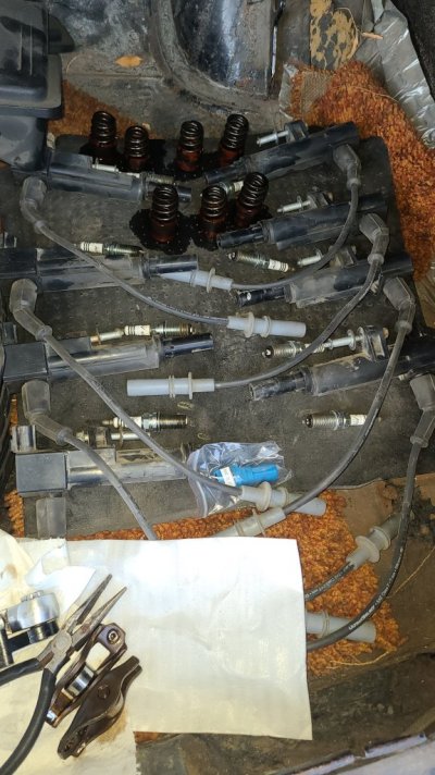

Once the left side was off I went to the right. Lowered the engine the same way, and still had an issue. So I pulled the fuel/injector rail and it came out.
Cam lobes all look good nicely polished,
A little pollen was on the spring breeze. Will definitely change the oil when all's done.

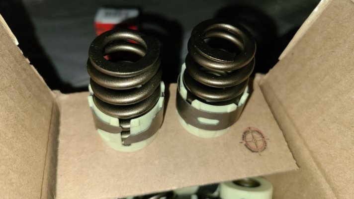

Day 2, I spent a number of hours farting around with the first spring and figuring how to get the keepers back in. Was surprised that what came with the felpro seals was a full set of replacement valve springs.
