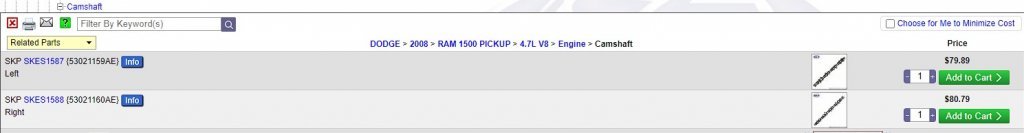

Camshafts are priced fairly cheap on Rockauto.

And I just saw that the camshafts listed on Rockauto were the same part numbers as the 2002, so they are not the ones that I need.

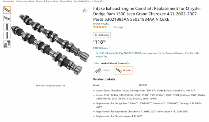

So, I did a search for the original part numbers 53021983AA & 1984AA a Seller on Amazon has them listed for the 02-07, are they correct?
But some other sites list them for the 08 but for the Flex Engine. There is confusion starters when looking up these camshafts.
