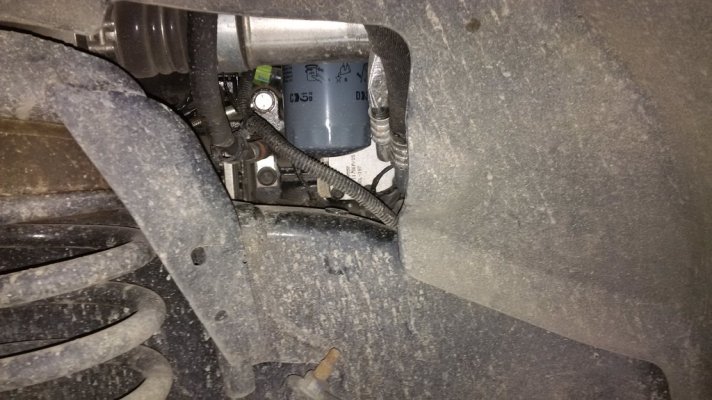

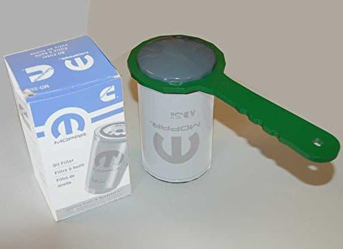

Get yourself a screw in plug for the oil filter, they sell them at places like Geno's Garage. Get to the oil filter through the front wheel well.

Stuff a small towel in the cavity below the filter , just enough for it to rest on when undone . As mentioned get yourself a screw on plug for the filter , Amazon or Genos . Screw on the cap ,they have a ring to get a hold of ,and pull it out thru the fender . Let it rest on the towel that's filled the cavity while you screw on the cap . Been doing mine that way since my 2014 was new . If you are one that likes to pre-fill the filter, then do that , put the cap on ,and slip it back thru the fender , let it rest on the towel remove the cap . Raising it up in there can be done with one hand ,it has no where to go but up , and screw it back in , it takes a little practice ,but it's not that difficult . Might take a couple try's before you get it started screwing it back on . I did the intake tube one time ,that was enough to cure me of doing it that way . Couple times doing it thru the fender , and it becomes easy .
Couple tips , one turn you tire all the way to the left , gives you a bit more room to reach in there . I use a filter strap to loosen ,and tighten . I use the Donaldson filters they are smooth on the bottom . If you are using Mopar or fleetguard get yourself a filter socket that fits on the bottom , and a flex-head 3/8" ratchet .
As far as the rear fuel filter get yourself a piece of clear plastic hose , I believe 3/8" ID , and loosen the valve ,and drain the filter in a bucket before removal , give a minute to drain out . I would think you could find a YouTube video on both the fuel ,and oil filter removals that I have explained . Same with the front fuel filter , that one takes a 5/8" ID hose to drain .

In case you have, or know someone with, a 3D printer:

"Get yourself a screw in plug for the oil filter, they sell them at places like Geno's Garage. Get to the oil filter through the front wheel well."
+1 on this
Worst freakin' oil change experience, by the way, but manageable with the right gadgets. I splurged for the Geno's stuff as crash68 mentioned and it made it a lot easier and no mess.
