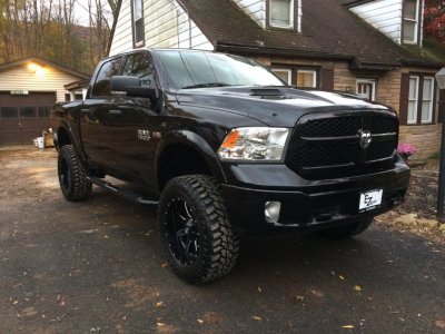

The 4” rough country will come with new spindles to keep all the angles correct to keep from ruining parts like those cv axles. Rough country is just perfect for a mainly road use truck. It’ll handle light off roading no problem also. Had a rough country on my 2006 for 5 years and no problems and now my 2015 has a 6” rc lift and it rides damn near as good as a stock ram does. A 4” lift and 35’s will look good together if you’re worried about too much height with a 6” lift, but keep in mind rc lifts aren’t exactly true 6” lifts. They lift the front 6” and the rear 4” to get a level stance so they don’t sit as high as like a zone 6” unless you get the zone with the 3” rear lift to achieve a level stance like the rc. A lot of the lifts are 6” front and 5” rear to maintain a factory rake hence the reason people add bilsteins on top of their lift to get it level which is fine if you want all that height but my rc 6” sits level without those. Just some things to keep in mind. Here’s a pic of mine with 6” and 35” tires.

Nice truck. I like it but it's higher than I am looking for. What offset are your Mavericks, -12mm? Fuel just came out with a new wheel I'm leaning towards - similar styling to the Mavericks but they are -18mm (Fuel Vandal). I do realize that the lift kit measurements start with the total front height and then subtract out a couple inches from the back to account for the factory rake. But I just don't need to go up that high for my purposes.
Yea they’re -12. Stick out just a bit past the factory flares. Those vandals are a good looking wheel to. I wasn’t trying to turn ya towards a 6” lift, just was using mine as an example of what I was saying. A 4” lift and 35’s look great together. Just enough to give the truck a cocky sportier stance.
