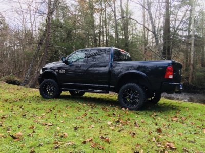

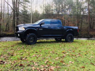

The 4” rough country will come with new spindles to keep all the angles correct to keep from ruining parts like those cv axles. Rough country is just perfect for a mainly road use truck. It’ll handle light off roading no problem also. Had a rough country on my 2006 for 5 years and no problems and now my 2015 has a 6” rc lift and it rides damn near as good as a stock ram does. A 4” lift and 35’s will look good together if you’re worried about too much height with a 6” lift, but keep in mind rc lifts aren’t exactly true 6” lifts. They lift the front 6” and the rear 4” to get a level stance so they don’t sit as high as like a zone 6” unless you get the zone with the 3” rear lift to achieve a level stance like the rc. A lot of the lifts are 6” front and 5” rear to maintain a factory rake hence the reason people add bilsteins on top of their lift to get it level which is fine if you want all that height but my rc 6” sits level without those. Just some things to keep in mind. Here’s a pic of mine with 6” and 35” tires.
If your debating it then get the 6”. I debated it and ended up spending more money to convert my 4” to a 6”.Hey do u have any more pics? Side maybe? I have a 2010 sport that I’m trying to decide between a 4 and 6” lift. I would probably go with RC and get their new struts that they offer. I have some xd grenade with 0 offset and 285/65/20 ko2 ready to rock. I just can’t decide if 6 is too much or 4 not enough and won’t be happy in the end.

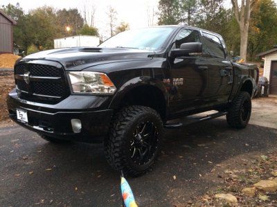

I’d go 6” if you’re thinking about it, like I said the rough country isn’t as bad since the lift levels it and the rear is only a 4” lift. I like the idea of those struts since they eliminate any spacers up front and they have good reviews from what I’ve read.Here’s a few more pics.Hey do u have any more pics? Side maybe? I have a 2010 sport that I’m trying to decide between a 4 and 6” lift. I would probably go with RC and get their new struts that they offer. I have some xd grenade with 0 offset and 285/65/20 ko2 ready to rock. I just can’t decide if 6 is too much or 4 not enough and won’t be happy in the end.
Clean setup. The cat underneath is inspecting your truck.I agree with all the others. I really debated between the 4"and 6" lift. I ended up going with a 6" and I'm glad I did. The 4-inch just wasn't going to be high enough. I ended going with the 6" BDS Lift and honestly my truck does not look that high. I am running the AMP power steps so getting out of the truck is not a problem. I'm running 35 x12.5x20 Toyo Open Country extremes on chrome fuel Maverick 20x10 wheels with a -12 offset. The BDS kit I installed was very well made but honestly I don't think it was worth the extra money compared to some of the other kits out there. I think if you go with a Zone or RCX lift they're probably just as good and cost a lot less. The sea couple pictures my truck with the 6" BDS and 35s it doesn't look that high.![]()

Thank you. I like the way it came out. That cat under my truck is actually my dog lol! He was a stray that showed up at work and I ended up bringing him home.Clean setup. The cat underneath is inspecting your truck.
