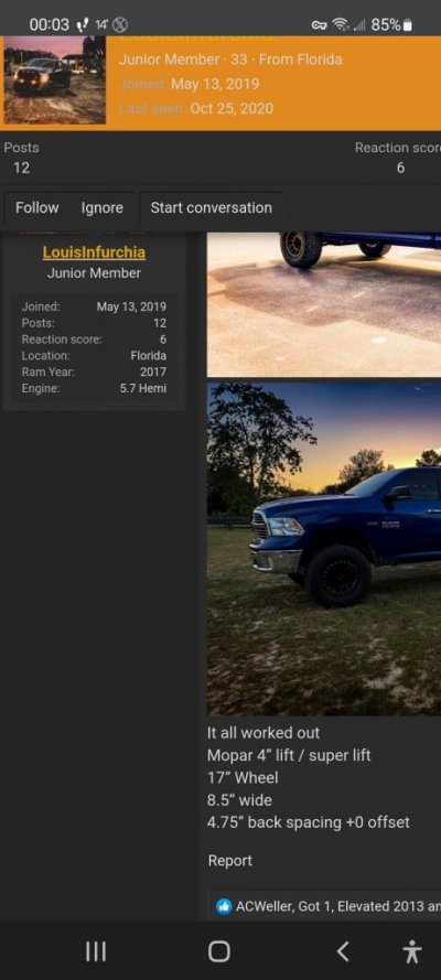

Just dropped off to the shop for install today. I will let you guys know what happens. Hoping everything fits!

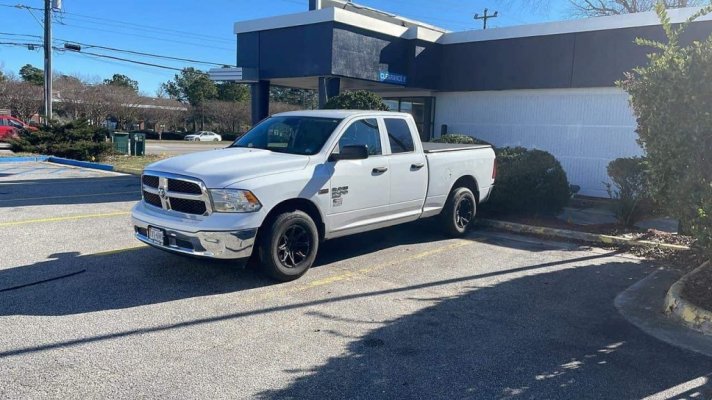

My insurance is either paying for a new frame, or a lift from the dealership, due to frame damage (destroyed tabs under cam alignment bolt) caused by the shop that fixed my truck after I was rear ended. The dealership provided estimate of $14,997.00 to replace the frame, or about $6k to lift the truck. Insurance is considering paying for the lift, Vice the frame, since it will fix the issue for a lot cheaper. The dealership says my TP brand 17” x 9” wheels won’t work with the lift, and obviously I will need new tires, which I need anyway and are going to be going with Falken Wildpeak AT3’s. From reading this forum, I don’t think this is true, about needing to get different wheels? Pic for reference.

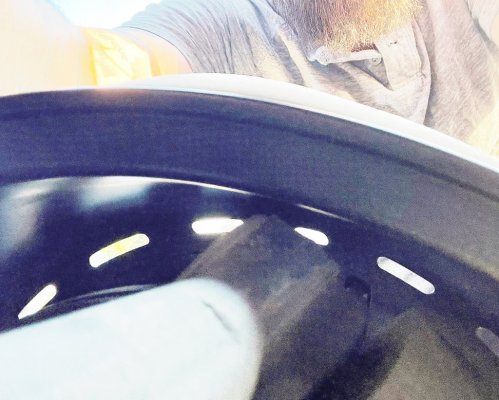

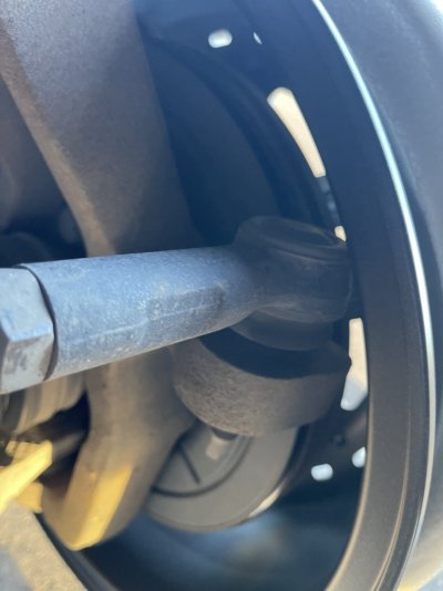

Is it working ok? How many miles did you put on it with the 17” wheels? Thinking about doing the same with 17x9 -12 and I have the mopar 4” lift.
How much room do you have to the tie rods?
FYI, Louisinfurchia has not been online on almost 3 years.
If you mouse-over or tap the username, you can see this info.
