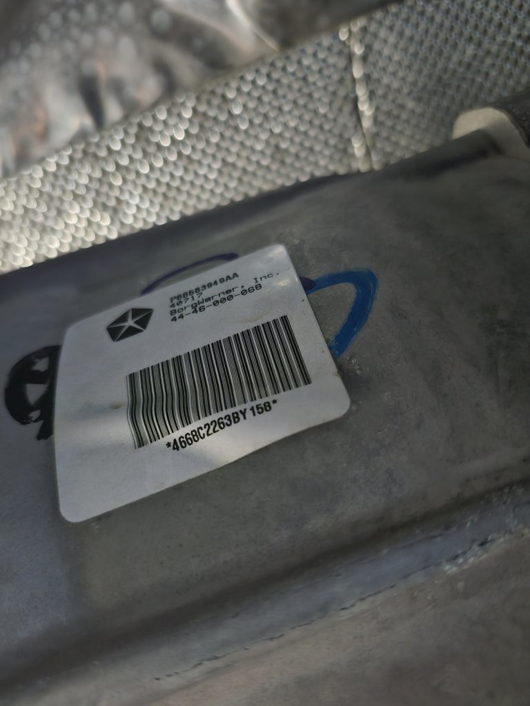

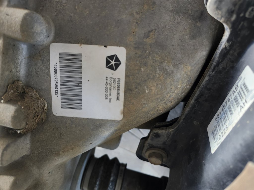

You can also slip under the truck and read the data-plate on the transfer case: BW 44-45 and BW 44-46 follows:20251115_123225.jpeg20251115_123938.jpeg
Hardracer
