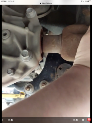

Well, both front cv shafts are stripped out at the front differential according to the dealership. Waiting for Maxcare Warranty approval to replace them. Fun stuff!!!

Ah yeah that'd do it! Atleast it isn't a front diff. Cardone makes a HD cv axle if max care dkng cover it.

I’m assuming they make it some the CV joints get destroyed before the differential shafts do???

No I don't think so. Just a ****** design I think. They have alot of slop from factory. When u get the new ones in you will see. Even from brand new they slop around.
