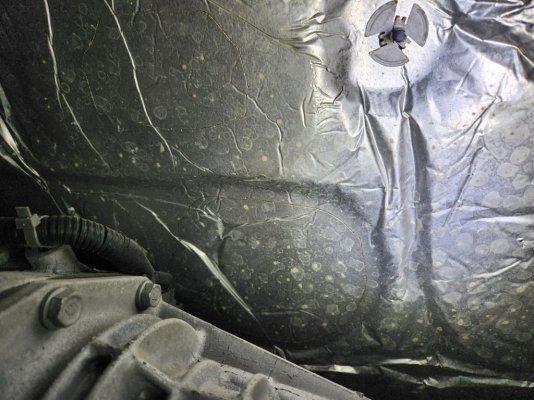

I did a little looking around underneath my truck and there is an area in the insulation under the cab that appears to be where one would cut out for a shifter.
Also, on my truck with SW headers a starter will not fit on the passenger side. As we know the motor is shifted right a bit, so with the header tubes coming down where they do here's no way to get a starter in there.

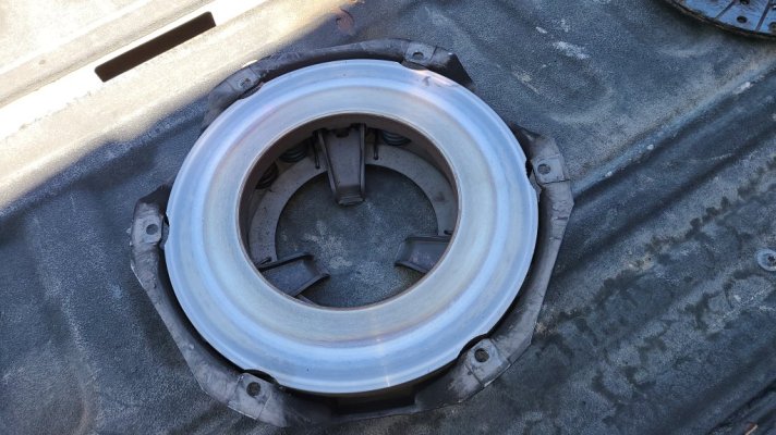

I see you didn't get your clutch h set yet. Hopefully you didn't settle for that LUK Chinese crap. Went through 2 warrantied ones in my old dart within 10k miles before I threw the third set in the trash after just 550 miles or so and bought something american made that would last and actually seat to the flywheel evenly. First set the pressure plate came apart, second set the clutch plate came apart. Ended up putting a rhino pak in to make it work right.
Pics of the uneven contact on the plate from the third set.
