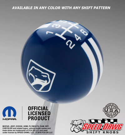

This would be good, since it is a Viper trans.
It's better then the pistol grip,lol. If you watch video's of any of the old 4 speed masters like Bill Jenkins / Ronny Sox etc.,they all used a t-handle shifter,it's the easiest handle to make power shifts with ;)
