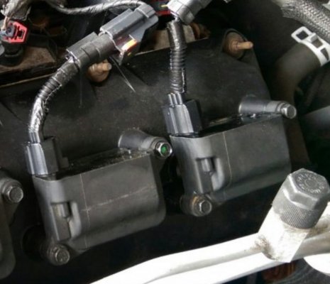

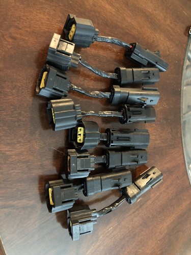

You don't need the harness, your stock harness will plug right into that engine. The variations are at the PCM end of things and unless you're converting to a 2005 PCM it doesn't matter.
Unless your soldering skills are extremely good or you have a full set of Molex tools and connectors, you'll need the pigtail adapters to use the later coil packs. The early and later coils use different connectors.

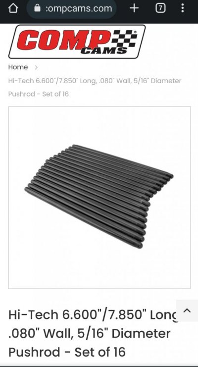

If you're going with an aftermarket cam then you need pushrods to match, as that cam will be based on the 6.1 cam base circle, so either 6.1 pushrods or whatever Comp recommends.

Soldering skills: check
All the tools to re-pin change pins etc: check
Still getting the pig tails: yup
Not sure what I want to do yet. Probably end up going comp rods to match my cam and have that sort of peace of mind. Like I said in dm, comp recommends a size almost the same as the factory 5.7. But I think I'm just going to order them from comp and not have to worry about it.

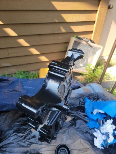

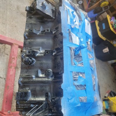

Couple more months of not having my truck and I'm finally getting busy on this. Still waiting on a couple things and I'm sure I'll need to stop for a bit to do some work around the homestead, but20230610_100103.jpg20230606_192623.jpg20230606_192642.jpg

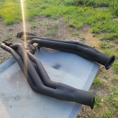

For comparison, this is how the headers looked before a TON of work. They got wire wheeled, ground, welded, ground more, acid bathed, torched, degreased, primed painted and cured. 20230611_233210.jpg
