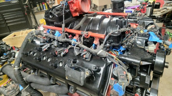

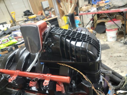

New valve covers are black instead of that metallic stuff I put on the old ones. Intake painted to match. Trying to figure out where I want to run all the wires.

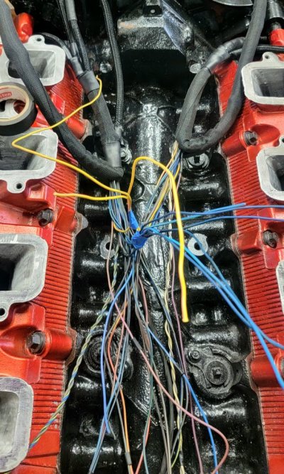

This is what drives me nuts about wiring harnesses. Tangled up for no reason. Grrrrrr

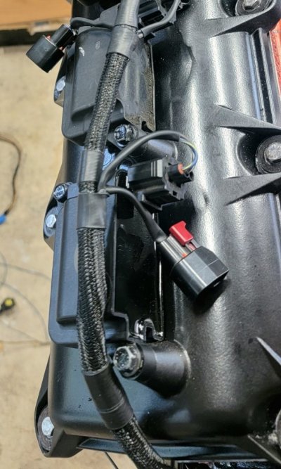

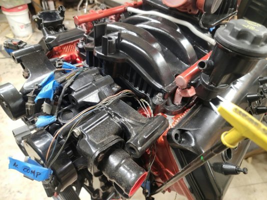

I think this is my basic plan. Seems to take each wire and hide it behind the closest thing to it. It's all getting wrapped in high temp braided loom and tape that will protect it so much more than the factory plastic junk in cutting off. I'll see what it looks like as i get everything back together and laid out in place. 20230704_205335.jpg20230704_205354.jpg20230704_205359.jpg20230704_205756.jpg

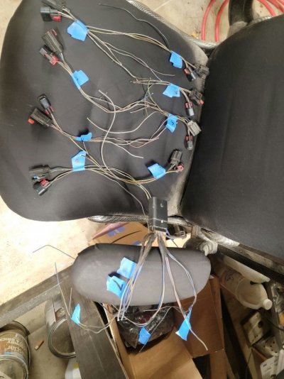

Ok final answer to the wiring harness debate.
So i went through both the 2004 and 2006 service manuals comparing all 4 pcm connectors. There are 8 differences on C1. 5 pins aren't there on the 06 and 3 are can bus or mds. Those 5 pins that the 04 has are kinda important like VSS. There are other differences but C1 was the one that sealed the deal.
I'm going with a hybrid of the two. The main advantages to the 06 are the connectors for the coil packs and it is routed much better and cleaner than the 04. I will be running basically an 06 harness to the motor with the 04 harness running to the pcm o2s tranny etc. This means I don't have to mess with the vss and such. I will be using the 04 PS sensor that doesn't exist on the 06 as well as the 04 oil pressure sensor. It was also easier to cut out the mds and can bus wires than it would have been to pull them out and put the 04 stuff where it was different on the pcm side of things
And I am SOOOOOO glad I went and dropped 6 whole dollars on this guy
I think he needs a beard and some tats.
I'm about 40 connections into this project and having that holder guy has been a life saver.
I've also 3d printed different versions of a tool to feed wires into the loom I'll be using. Testing the tool seemed to work unbelievably well. Hopefully in real application is just as fast.

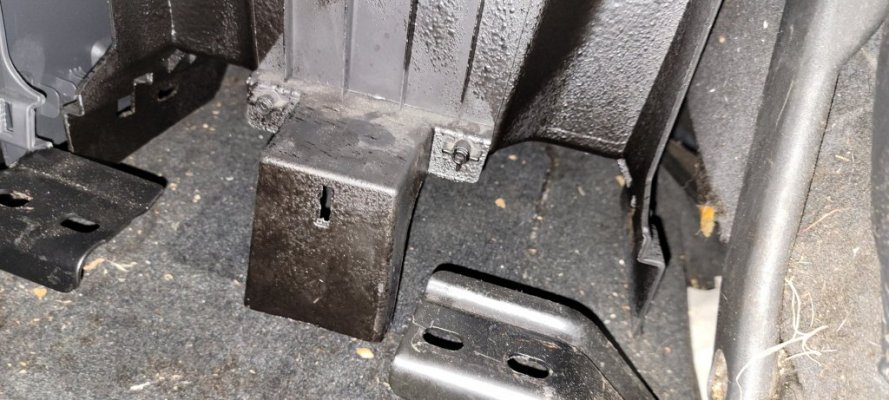

Sat it inplace for a test fit. I think the first step is going to be cutting the jump seat brackets off the seats. They are very in the way. I can't even get a decent idea of fitment because they are so in the way.

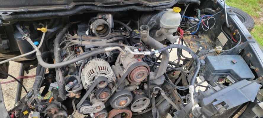

Also got the old motor out of the truck. Pleasantly surprised how clean everything is. Very minor surface rust. I washed the engine bay with degreaser and streaming hot water. No pictures of that but I need to get some pictures of the rust situation so I can brag to my buddies up north about how little rust is on my 20 year old truck.

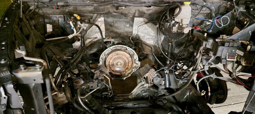

Took a couple quick pictures of the cleanliness of the engine bay before I started this morning. Still pretty excited about how little rust there is. This would never happen in New England. 20230808_094608.jpg

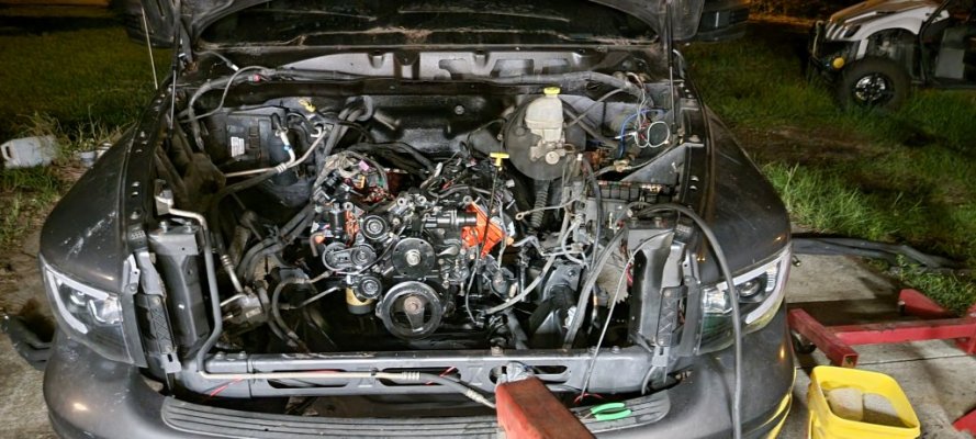

Been gone for so long you all probably forgot about me. Not sure where to even start.
Motor went in. Ground issues wouldn't let it even try to Crank. Fixed that
More ground issues wouldn't let it start.... seriously? Fixed that
Injectors/ coils wouldn't fire correctly. Acted 180 out. Small ether fire might have happened. Fixed that but I don't know how. I unplugged everything to check and when it went back together it worked.
Truck started but wouldn't idle. Sounded mean af though. Found clogged injector and dead o2. Fixed that.
Truck idles but makes horrific noise. Turns out the dust shield got tweaked during install and the converter bolts were touching.
Seriously I can't make this stuff up. Plate stock didn't have enough to pry the piece back. But I wedged the plate stock between the bolt and that shield piece. Then I turned the Crank by hand. The bolt pushed the plate stock outwards clearancing the shield as it went. Did it three times One with like 16ga and then again with a piece of 1/8" stock. Then I wedged both pieces in there and did it one last time. Now it has good clearance and no noise.
Needed to get the interior back together and wires run for everything. Literally almost died from the heat. Good times. Carpet in, wires ran ziptied, taped etc, and seats back in. Plastics still strewn about the garage.
