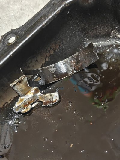

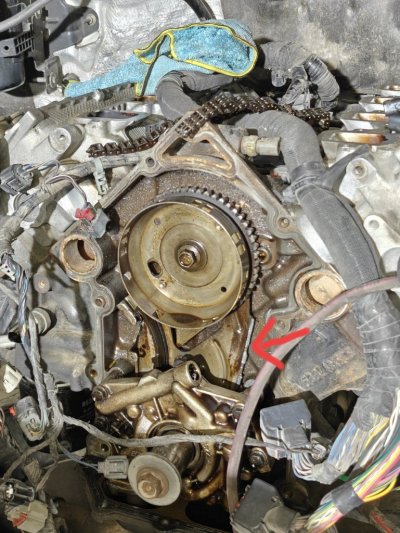

So, after about 12,000 miles on this fresh short block I put together earlier this year one of my NOS Mopar lifters started making noise and it never stopped. That is until it completely collapsed at 60mph on Interstate 35 South and then
WHAM-BANG-POW goes the timing chain tensioner. The guide on the left side of the tensioner sheared off and the timing chain got bound up in the commotion and broke the chain. Since the chain broke while driving at 1500RPM I had to contend with two bent intake valves, two bent exhaust valves and a bent pushrod along with the collapsed lifter.
I was really disappointed about how this motor looked inside after a fresh build and 12,000 miles in just under 9 months. The Mopar lifters were a set I had saved back in 2021. The timing gears were from a Mopar set and the tensioner was from a Melling 3-704S set I had in the shop.
I found a ton of oil in the intake manifold and the oil control rings had too much carbon buildup in them.
So, here is the damage...IMG_20251101_175633.jpgIMG20251021133005.jpgIMG20251025122716.jpg

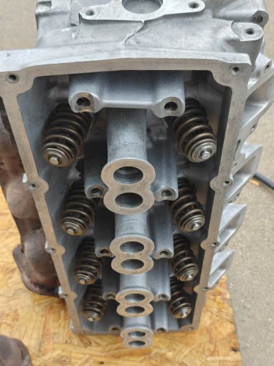

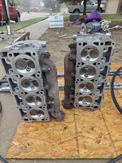

Now, here are the cylinder heads after a full cleaning/inspection, sonic check of the deck/head surface and two valves replaced in each head. I was pretty disappointed to see these heads get hurt because I have invested over 40 hours into the port work and they flow great. My handy work was worth an extra 37cfm on the intake side and an extra 19cfm on the exhaust side. All flow number were conducted at 28" of vacuum and these numbers were at .600" lift. IMG20251025135530.jpg
