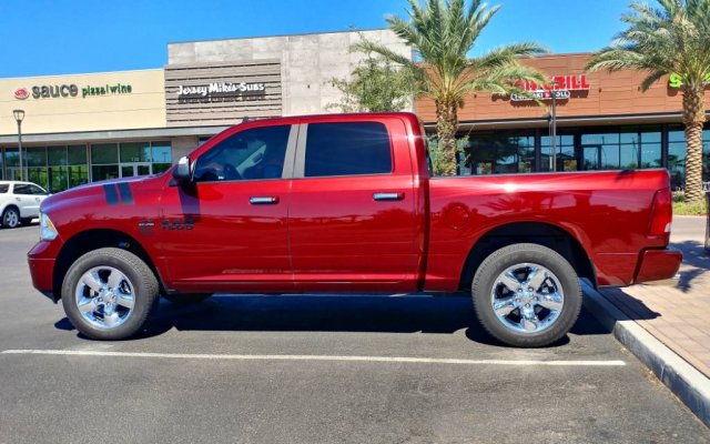

Thanks for the comments. Thanks for those that answred my silly questions. 1500s are different coming from 2500s but.. Simple. Haha67d3bdf9a01b744f47a8f2b81f414797.jpg

Looks great. How's the ride. I just picked up an eco diesel last week. a spacer already from previous owner, sits level but is an absolute marshmallow on the road, plus the strut squeaks like a bird being squeezed. Had 5100s on my f150 I traded in and they weren't bad but I know once you jack them up to max lift they are all reportedly harsh. These are some of the best riding stock trucks, imo. I had a 2500, thuren suspension and if I can get that thing to ride nice I'm sure these should be cake.

Seems to be a bit more harsh under 5mph, but after that its hard to tell. Haven't had it off-road yet. But 5100s on my 2006 1500 (last time I had a 1500) did well. Nothing like my 2500 with Thuren.. But that's a different league.

Oh I know all too well. Had the thuren 2.0 on my 2500, buddy had a carli 2.5 on his. No replacement for big shocks. Only reason I ask is I had a 2013 f150 I literally traded in last week on this truck. When I initially had my 5100s installed they were set at 2.75 lift and I literally had no droop travel and it was horrible to drive. Worse than a stock 4500 empty. I ended up pulling everything off, dropped the front to 1.5 than had to do a custom rear combo to keep the rake acceptable. Don't wanna have another headache like that. Granted these trucks definitely need a firmer setup I'd like to stay away from stiff springs and make up for it in better damping.

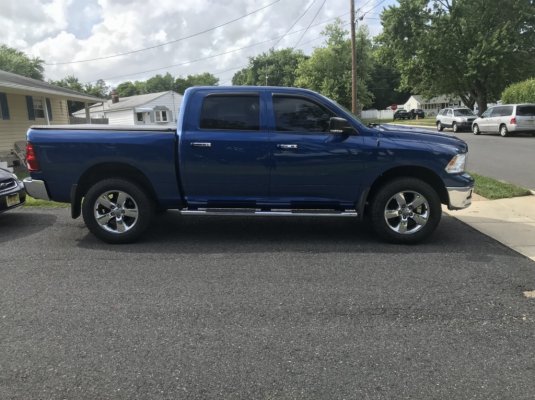

Looks good! Liking that hood strip! Where’d ya get it? Also just did the 5100’s and I gotta do my headlights too!95ae5775f2e1a927ee972663273f55d4.jpg

Thanks, hood stripe I bought on Amazon, found a flat black set, and trimmed it down to my liking. I love the look. Had it on my 2500 and got asked about it everywhere.
I did my headlights, just haven't drove at night yet. But the passenger side didn't want to lower itself as much as the driver side. Weird.

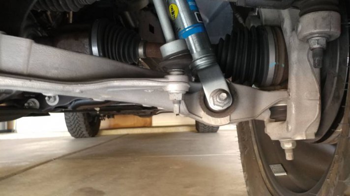

I am. It's not that much of a difference, however, think i may have a little vibration at like 10mph.

Me as well. DW was no joke.
My axles look to be ok angle wise too. Maybe it's just the MT tires I feel..

Those angles look perfect. I mentioned in my other thread that these trucks lifted have similar angles at the cv and upper bj to my f150 at stock height. And that's at 2.8 of lift. But after everything I've dealt with I go by what I say more than what I hear to establish my own ideas.
On a side note can I ask a favor. Can you get me the numbers off your truck for the droop travel left at the 2.8 setting. I measured at ride height, than jacked up by the frame and pulled 4" roughly. But I have a spacer and wanna see how much is left with the 5100 setup. Got some ideas I wanna look into but need some baseline numbers to compare to.

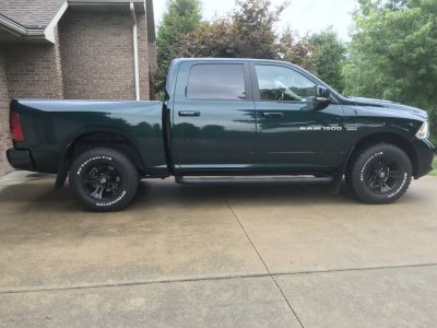

Hey, I apologize in advance for being totally unknowing about the subject of lifts/suspensions.
This is my '11. It has a front end puck lift, either 1.75" or 2". Had it done a long time ago. I can't remember which.
My OEM right front shock is leaking. I'd like to replace all 4 OEM shocks with something better. Been thinking Bilstein 5100. I'd have a shop do the work, and I'm not sure they know any more than I.
My questions: Does the Puck come out? I'm thinking it does.
Where do I tell my tech to set the front shock to stay at the current front end height, or possibly just a 1/4" higher in the front?

If your truck is a 4x4, you have struts up front and rears will be shocks.
The spacers or pucks can be removed. If getting new 5100 struts, they should be able to do the entire front in about 2 to 3 hours. It took me 3 hours and I was taking my time and stopped for lunch.
Id set the struts per instructions for a 2.1 with yours if you want to keep the ssme height you have now. I believe that is the 3rd ring up if my memory serves me correctly, but all illustrated in the instructuons.
