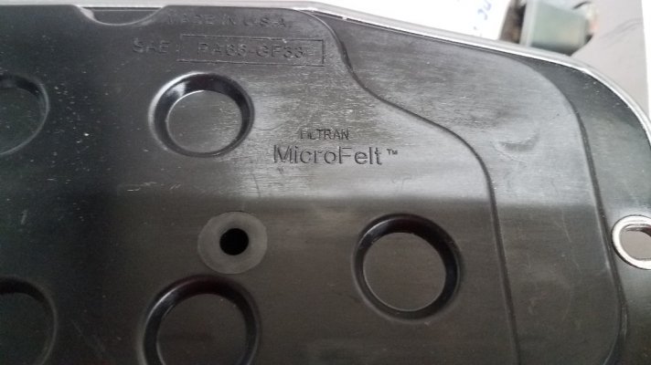

So this is my finding so far. I'm really hoping it is the only issue, and that it didn't cause any harm to the rest of the transmission. Cheap Chinese filters!!!

Makes me wish I left the oem on.

I bought this one off amazon, I hope it doesn't do this. It says Mopar..
Mopar 5013470AC Oil Filter and 05179267AC Filterpkg-Transmission Oil Bundle

That's definitely not a Mopar filter. Here's a pic of the top of a Mopar filter, says "made in USA" at the top of pic....78a0e6cbf4e5c4f93e7ce579360a6cea.jpg

When I put the metal threads on I will look. When I did my pan drop I hadn't received the metal threads from Kyle yet.
