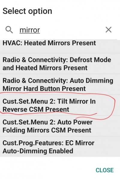

I am also having problems enabling the tilt mirror in reverse. First of all I noticed that when I tried Programing it, it says it’s already enabled. But I enabled it anyway. Somewhere I read that I should see it in the radio settings on safety, but I don’t see it.
Anyway, no luck. Did I missed something ? Thanks
Did u try this one for radio menu option ? ....

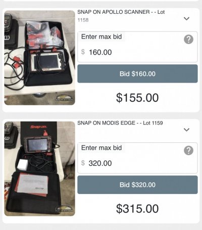

To do some of the stuff in here y’all talk about which code reading device should I get? Local auction has these
Jimmy07
Feb 23, 2017
3,507
3,548
Neither of those are capable of doing what AlfaOBD does.

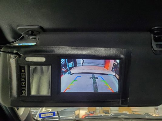

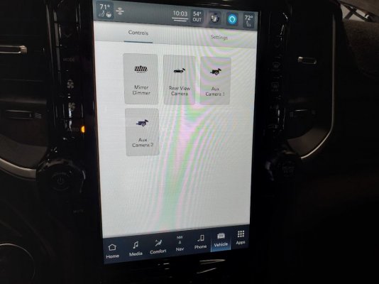

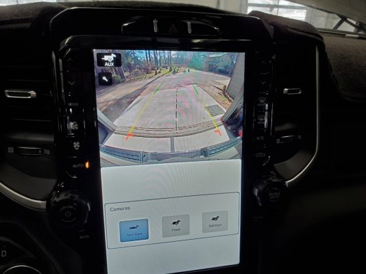

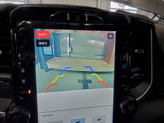

umbighouse - here are the pictures you requested...the first picture is from the OEM reverse cam...at the bottom it displays icons of the 2 AUX cams added via AlfaOBD...I named one "Front"...which I use for front parking...the other I named "360 Cam" (my plan is to add a after market 360 surround camera system...once I get up the nerve to drill holes under my side mirrors. The 2nd pic is of a view from the front AUX cam...up in the top left of the image is a icon/label for both AUX cams added. The 3rd pic: I currently am using the second AUX cam feed to display an image to a LCD screen I'm experimenting with in a modified driver side sunvisor. The 4th pic is of the 12" Uconnect 5 Vehicle settings screen...the 2 AUX cams show up as Aux Camera 1 and Aux Camera 2, and can be accessed from the screen. The 5th pic shows the 2 AUX cams populating the Uconnect 5 Apps screen...the AUX cams can be accessed from the screen also.
