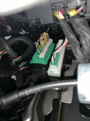

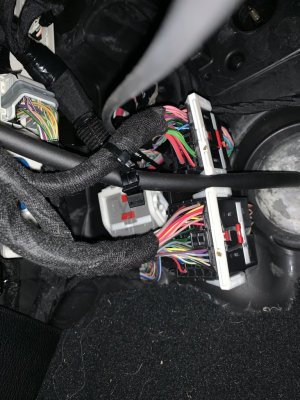

Mike sent me a diagram, should be on the drivers side but must be up higher above the bcm than our 4th gen. These are some pics of the area on the 5th gen, where it would be on the 4th gen. I’m thinking it’s goung to be up higher over the bcm.
F49B60D2-CAF6-4F8E-B5FE-50E3269C3712.jpeg 0F1BA38E-0FF8-4175-86C1-37D072C42BBE.jpeg 818F4E5D-352C-4BB9-A805-DF05CF0B7CE4.jpeg

Sweet. Depending on length from the obd2 port the current 2500+ Bypass should work.
Ok I have one on my 2500, I’ll give that a shot and report back. Probably will be sometime next week. I think I’ll try something easy like turn off the drl and see if it works.
The 2500 harness worked perfectly as far as length, I set no horn on lock and no horn on remote start. Alfa said procedure complete, now just waiting to see if it works. He has push button start so not sure how long it will take, I tried cycling off to run a few times but settings haven’t changed as of yet.
I was also able to read the bcm and create a log, once I upload I’ll edit this post with a link.
I got to see the CAN connectors in person today also on a 5th gen. They are way up in there. Did you have a hard time reaching up in there to get to them?
Not at all, was a bit tight squeezing my hand through but it opens up above that bar, wasn’t hard to get back out either.
Good news I was able to add the sound horn on remote start csm as well as turn off horn on lock and sound horn on remote start.
I also was playing with firing lights on and off and locking and unlocking doors and it all worked fine.
I’m going to say that the 2500 harness and Alfa will work on 2019 1500, but people will have to test things and start a known working list for 5th gen.
