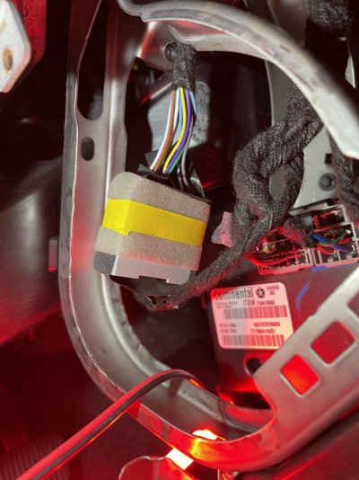

So I got my new table,cable and reader the first task is to fix my rear parking sensor service light since I kinda broke it with my trailer lol and it threw a code anyone done this one yet? Will be my first time doing something like this been watch YouTube and hav learned to backup my files first

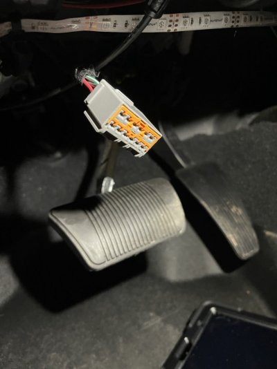

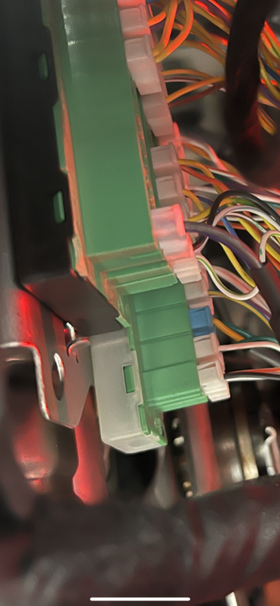

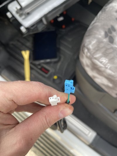

I can’t find a specific video for my bypass cable install I found the location i believe and another obd2 port connection it looks like. The question where do I connect the blue and white wires does it matter? On in the gray/green and the other in the green/black block? I’ll get a picture of that when I go back out

Found this I thought it was the obd the orange one apparently it’s this yellow taped one

Connect the white end of bypass cable to green/black and the connect the blue end of bypass cable to green and white. Connect obd2 cable to obd2 port next to the puddle light under dash and then connect your reader
