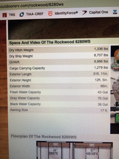

Looking to purchase a 5th wheel, just wanting to get some feedback from those who know. I’m assuming I would be OK with this one, but would my Cummins have any problem towing this trailer?

The brochure pic is from a travel trailer and your title says 5th wheel???

Not sure about the whole 5th wheel or travel trailer deal but based on what I see in the pic, your Cummins will laugh at that load and beg for more.........
If my math is right, Max load would be 11,100 lbs

I guess the whole fifth wheel thing confuses me a bit, apparently we are no longer talking about tongue weight, correct?

Correct. Looking at the previous pic, the unloaded vehicle weight was 8,500 pounds and change and a carrying capacity of 2500 something. Tongue weight was like 1000 which is heavy but still in spec for a bumper pull and easy for a 5th wheel
Looking at the updated pic, you’d still be good. With a 2500 CTD you’ll be close to max payload but that really depends on how much you have in the truck with you. Check your yellow door sticker and see what your payload number is.

Not sure about the hitch.
But are you serious about wondering if your diesel can pull a 8500# trailer?
Well I’m looking at 5th wheels that are 10,500# and my truck has the 6.4
