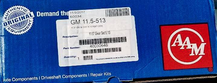

AAM Part number for the 5.13 gear set, 9.25 front differential is #40136007 and rear 11.5 is #40030646 (pic shown)
2016 Ram 2500, 6.4 L, 6 Speed, 66k mi
35" (34.5") Mickey Thompson MTs worn to 33.75". I run 91 octane with a Hemifever tune and longtube headers.
Take my gas milage with a grain, I post for informational purposes only, I love to make my truck jump and go. All a Ford has to do is wiggle near me and I am on it. Many trucks see Power Wagon on my tailgate and they come flying after me, I show em full throttle in any gear and they stay back and don't even try, no shizzle.
I did the regear for 37" tires, I'm enjoying the experience with 35s so much I haven't bothered with the 37s yet.
Traffic flys out here, 85mph in a posted work zone will keep you alive but not unharassed in the left. My truck handles the crazy high speed no problems.
I drive elevations from 6,700ft to 10,000ft regularly and above 10,000 ft as often as I can.
If I could take my foot out of it who knows what kind of mpg I could get but so far no luck there.
I don't tow , but she's usually loaded down with gear. With a Full tank she came in at 7,640 lbs on a certified scale.

Any other info I can help with, let me know. c2bbc237681570a57c443126e12932d6.jpg
