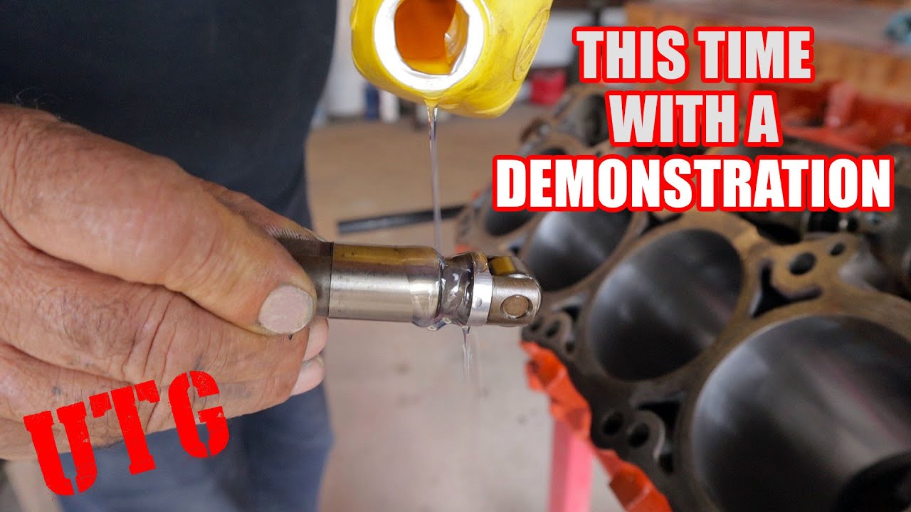

Engine architecture is basically the same isn’t it, even though it’s a different block casting. So seems the cam/lifter issues would be common. I wonder if the 6.4 utilizes a higher volume oil pump as standard for HD use. That might help with the cam/lifter issue somewhat.

Same oil pump. The size or volumn of the oil pump doesn't have squat to do with the cam / lifter issues.A little research other then Re-ignited video will tell you,there is "No" pressurized oil fed to the cam lobes or lifter roller,they're strictly lubricated by the oil flung off the crankshaft. You get more oil onto them by upping the idle rpm,not by sticking a high volumn pump on the end of the crankshaft.Spend about 24 minutes and watch both these video's,and you'll know more about the hemi's oiling system,and it's shortfalls then most guys,and you'll also see why a high volumn pump doesn't do much in a hemi.
https://www.youtube.com/watch?v=LBc83ZkkmoY
Yeah, I watched all those videos last week (or week before - time flies) and understand the cam/ lifter angle/height, center oiling gallery, lack of splash, lack of oiling through the lifters to the rollers and cam, etc. Just wondering why some were saying the 6.4 didn’t suffer from the same issues. The only easy thing I could come up with was maybe for HD use they went to a high volume pump in the 6.4 which might send more oil down the push rods to the lifter cup to overflow and flood in greater volume down the outside of the lifter and maybe spread a little higher on the lifter body in the bores and then make its way down to the rollers and cam. But from your experience it sounds like it’s an illusion that the 6.4 isn’t suffering from the same ailments from the valve train design and oiling as the 5.7. So mystery solved.
The 6.4's have the same issues as the 5.7's do.The only reason you don't see that many 6.4's with issues,is there's not near as many of them on the road,and alot of the ones that are on the road are working right from when they're first started , and don't have the same percentage of idling hours as alot of 5.7's have , that are just daily driver grocery getters.As long as you're working a Hemi and keeping it in the 2500+ rpm range it's a pretty decent engine,it's when it subjected to short trips where it doesn't get fully warmed up , and might see 1500 to 1700 rpm at most that it'll have more issues.The hemi's not an engine that likes to be babied,it's happier if you beat on it a bit and use that skinny pedal like you're a teenager again :Big Laugh:
