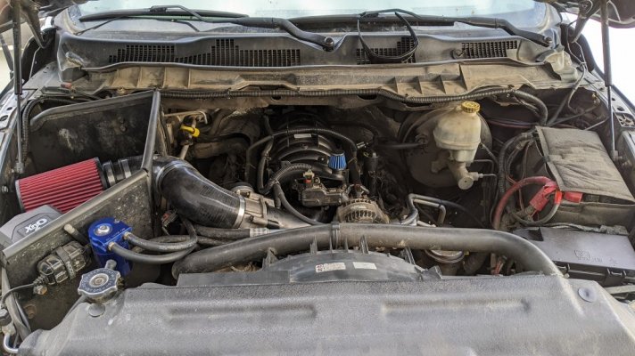

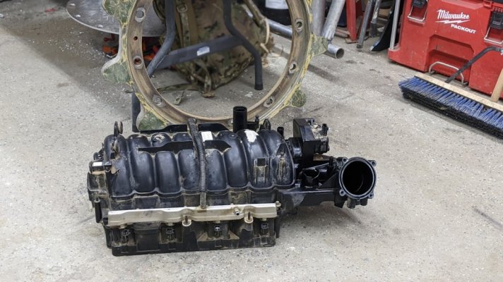

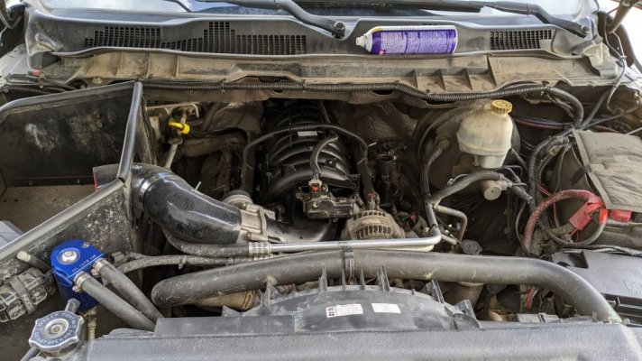

6.4 truck intake manifold and 6.4 stock air box is installed. Currently running 5.7 injectors with spacers. Now need to get a tune so I can swap in the 6.4 injectors and delete mds. May just have to buy a pcm from diablo... wanted to just unlock mine but may have to go the easy route. Can’t let my truck be down anytime soon. For anyone interested the 5.7 fuel rail does fit but needs a new hose for the crossover. Was a 5/16 high pressure fuel and transmission line. Also, drilled and tapped the 6.4 manifold to run my catch can. There is no way stock on the 6.4 manifold to run a catch can. If you look in the pictures you can see I drilled the egr blockoff plate and install a 1/2” barbed 90° fitting with a 1/4npt thread into the blockoff plate. The pvc side I drilled into the stock pcv housing and tapped it for another 1/2” barbed straight fitting with a 1/4” npt thread and just plug the stock vacuum port into the manifold so it only sucks through the catch can. Either jb weld or another form of putty should be good as long as it’ll harden and adhere to plastic. Posted in my build thread as well. This is with plans to install a aev snorkel in the future.

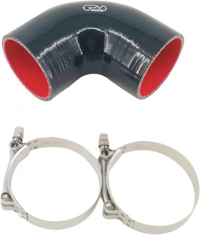

Im almost ready for the swap, Just waiting on my silicone elbow so I can reuse my 5.7 CAI .
I also got to swap the fuel rails around and put new seals on the injectors.

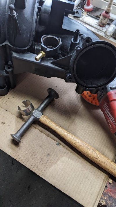

Made a little stainless sleeve to cover the hole. Its setting right now with 3M Weld Epoxy .
Used some Dupont Prep-Sol on the plastic and used a file to ruff it up to help with adhesion.

Had a busy day, Figured out what I needed for the air intake as well as extended the wires.
To bad I had to put the 5.7 Intake back on, Not a single parts store in this ******** had what I needed.
Had to order a AEM 21-2047DK 3.5" Inlet x 7" Element Dryflow Air Filter from Amazon as the MOPAR one wont work. Im not using the original 4" piping and I dont really want to Frankenstein anything either.
My AC lines are also super tight against my TB, Will have to bend them back a wee bit. Brute force and ignorance should fix that. lol

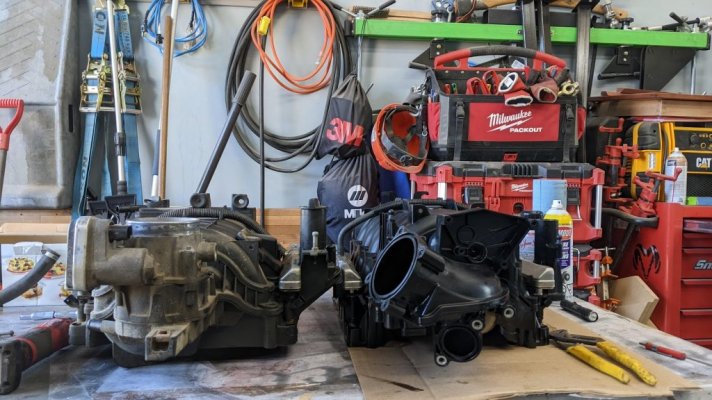

Cut some brackets on the plasma table this morning for my new intake. :p and fabbed up a few parts for it as well. ( Yes I know they have ones that fit , But doing it for free is more my style ) and I really dont feel like re-routing my winch controller box , Battery tender and catch can either !
Amazon shipped my crap this morning. Should be able to put it back in next Saturday.
Love this hammered black paint, I literally use it on everything I make now... lol...
