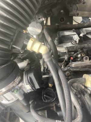

6.4 truck intake manifold and 6.4 stock air box is installed. Currently running 5.7 injectors with spacers. Now need to get a tune so I can swap in the 6.4 injectors and delete mds. May just have to buy a pcm from diablo... wanted to just unlock mine but may have to go the easy route. Can’t let my truck be down anytime soon. For anyone interested the 5.7 fuel rail does fit but needs a new hose for the crossover. Was a 5/16 high pressure fuel and transmission line. Also, drilled and tapped the 6.4 manifold to run my catch can. There is no way stock on the 6.4 manifold to run a catch can. If you look in the pictures you can see I drilled the egr blockoff plate and install a 1/2” barbed 90° fitting with a 1/4npt thread into the blockoff plate. The pvc side I drilled into the stock pcv housing and tapped it for another 1/2” barbed straight fitting with a 1/4” npt thread and just plug the stock vacuum port into the manifold so it only sucks through the catch can. Either jb weld or another form of putty should be good as long as it’ll harden and adhere to plastic. Posted in my build thread as well. This is with plans to install a aev snorkel in the future.

That’s why I went this route. Full bolt ons and cam are seeing up to 70hp and torque gains throughout the curve Originally wanted a blower but running these tires... figured I want more reliable power with less parts. The fact that it’s a straight drop in and if you are running fbo I would install the 6.4 injectors with it and have your truck custom tuned for the new injectors. I’m aiming for 400-450rwhp when I finish my build. Going FBO and cam. Possibly run a light weight ATI crank dampener as well.
NICE install!! Did you notice any difference in how it drives?
drivability is the same but with my small amount of mods I still feel better low end. I need to get long tubes so I can really unlock the full potential of this intake. There is plenty to be had from this intake.
