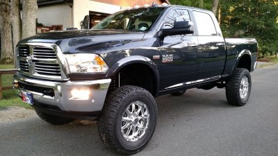

My 2016 3500 with the 6.4L Hemi and 4:10 gears.
With 37" X 12.50's I get about 11.5 mpg rural driving.
With the factory tires I get 9.5 mpg rural driving.
I ordered the 4:10's because from day one I knew I was lifting it.
I did the lift and tires the second day and at 40 miles.IMG_20150822_191548313 - Copy.jpg
I did the lift and tires the second day and at 40 miles.View attachment 168340
