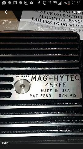

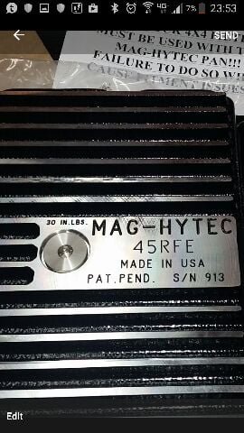

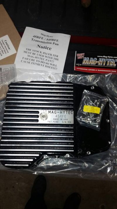

@R.L.K., can you take a pic of the inside of the pan? I can't remember if the drain hole in the MH pan sticks up at all...

I'll try to remember to do this in the morning Sir !

Damnit , I 4 got to take a pic of the inside .....
