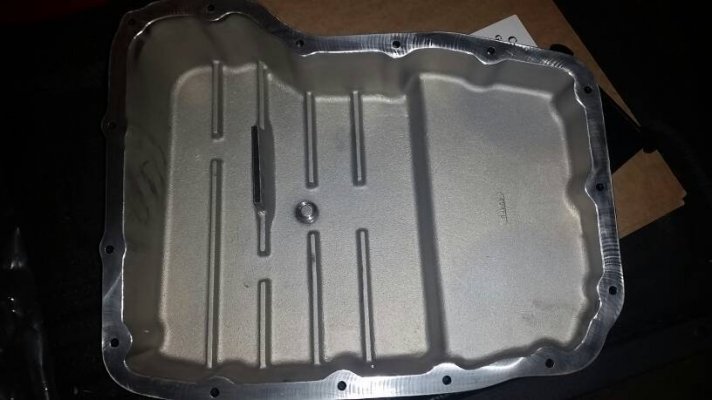

@R.L.K., can you take a pic of the inside of the pan? I can't remember if the drain hole in the MH pan sticks up at all...
Here ya go buddy !
Just some baffles / internal cooling fins and that strong ass magnet on the drain plug .

Thanks man that's just was I was looking for! I meant to take pics of mine but forgot.
Looks like that is just a threaded hole which is great because all the fluid will drain. A drain plug kit opening will sit 1/4" to 3/8" above the bottom of the pan.

And yes that drain plug magnet is strong! I didn't even bother putting my stock magnet in. Plus I really didn't want it floating around in the pan since it won't stick to aluminum.

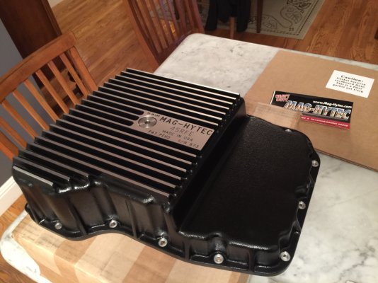

Nothing looks better on the kitchen counter than a new transmission pan[emoji3]!!! (My wife was like, WTF dude, take that **** out to the garage).
I've been following this thread for a while and decided to pull the trigger.....What a nice pan the MH is. I also have the MH rear diff cover as well, and they are very well made.
Looks like I'll have to wait a couple weeks to install, but I'll post up some pics of the process. Thanks for all the information, this thread is 65rfe gold.

Awesome , defiantly take plenty of pictures of the drop , filter replacementS and the new sexy MH pan install !
Oh and the type of fluid you go with .
