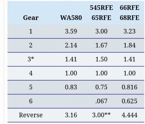

Yeah that’s just bleh. Personally if they just included 2nd Prime in the regular shifting that’d be so much better imo. there’s only what, a 200RPM difference between 4th and “3rd” at 20MPH?
Sent from my Blue Onyx RAM 1500
I just looked it up and the difference between 4th and 3rd/2nd prime is quite a bit. It's the difference between 2nd and 3rd/2nd prime that's about 200 rpm difference. I attached a pic of the gear ratios of the 545/65/66RFE trans.
My custom tune has the 6 speed sequence shift pattern in it and it does help a lot on the upshift. That 2nd prime/3rd gives a nice transition from 2nd to 4th. BUT it still likes to lug 4th way down below 30mph. I feel it should downshift to 3rd/2nd prime when the truck goes below 30mph...c429bb3810d2a7214ef12d118449191f.jpg

God does it ever, i hate hitting 4th after taking off from a stop. It’s like it accelerates beautifully until it hits 4th then it’s just bleh.
Hemi395
Mar 18, 2013
9,506
17,675
Cape Cod MA
Yup! That 2nd to 4th shift is brutal. You wouldn't think 200rpms would make a difference but it really does help. It's much smoother acceleration...
