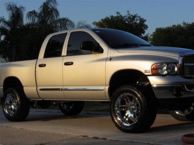

I have an 05 2wd lifted 6", 20x10 motos with 33" nittos. 33's can look good if you have an aggressive enough tread pattern. I don't think they look too bad.

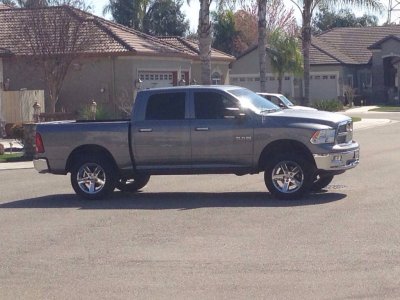

ImageUploadedByTapatalk1426013983.031362.jpgheres mine if this helps. It's a 2wd. I did the 4" CST spindle lift with a 2" spacer up front and the 1.5" coil spacer in rear. Wheels and tires are stock and 33". ImageUploadedByTapatalk1426014058.434803.jpgImageUploadedByTapatalk1426014068.580034.jpgImageUploadedByTapatalk1426014077.513282.jpg

That actually looks really good man, and with my plan of running 12 wides I think it will definitely NOT look too small.

I got the 4" spindles and the extended brake lines and the 1.5" rear coil spacer for $783. I went onto CST website, clicked on the dealer tab, then clicked to online dealers and went onto performance suspension. That's where I found it for that cheap. I'm still running all stock shocks and springs. The only thing is that if you wanna go over a 1.5 in spacer in the rear you would have to get a longer shock, or and longer spring and shock with no spacer. As far as up front it all stock besides the spindle, and spacer with new brake lines. Installation was easy as well. Took me and my dad about half a day for the front, and about 30 mins to do the rear spacer.

No sir. And no rubbing issues at all. I ran into that too when trying to buy mine is that everyone told me it wouldn't work I couldn't lift it and keep stock rims and tires on, but I called CST and asked them, they said no and were right. Plenty of clearance with no spacers.

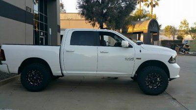

Here is my 2014 CC 2wd with the 4.5" Maxtrac spindles and 1.5" rear spacer with bils in the rear only ( fronts out of stock ) 18" Fuel wheels and 35" Toyo R/T tires
