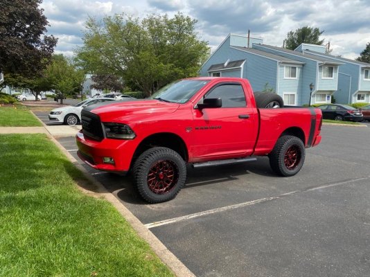

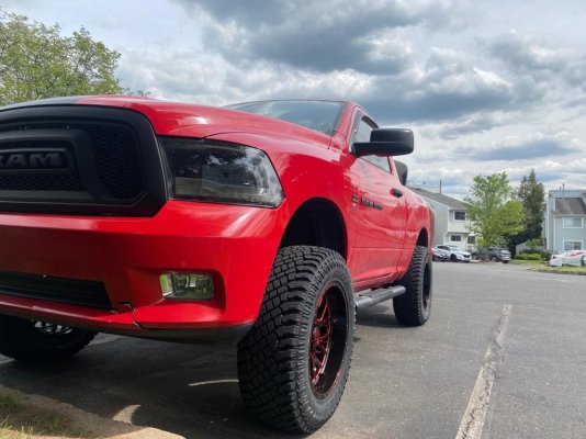

I have 2014 Ram 1500. Can’t wait to put a lift on and breath some new life to it. Please post some before and after photos.
Definitely sagging a little bit in the rear, but I also have 400 pounds or more in the bed with the wheels and old suspension. Hoping once I remove the stuff in the bed later today and the suspension settles over the next few days that it will look more even. If not I will have to look into adding an inch to 1.5 in the rear.

Looks awesome. Nicely done.
