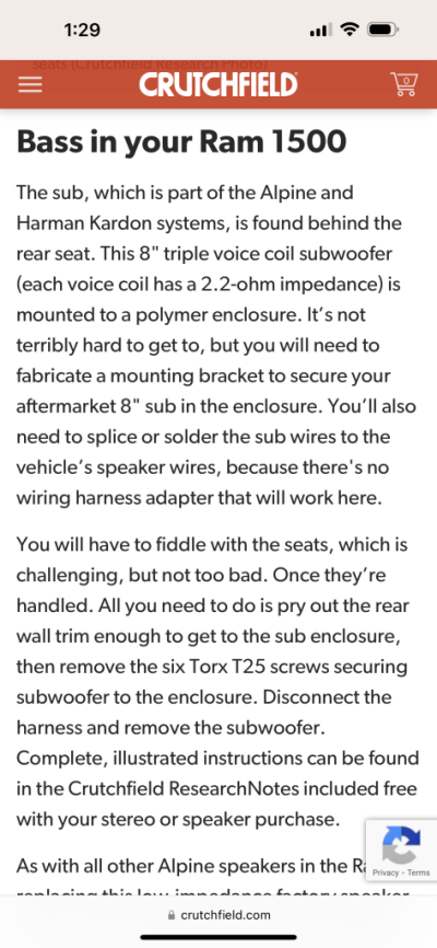

You can still swap out the sub. I have never heard of a 3VC sub... that doesn't make sense. Can you give me the part number for it? Also, you should still be able to swap out regardless - amps that have subwoofer dedicated channels typically don't need to use all the channels for a sub in order to work correctly. You can also do a couple of things by using just one channel rather than two (or three) for the sub - but you'd have to be careful since this doesn't sound standard in any way, shape, or form. If you pull out the sub, are there three connectors, two, one? Can you post a pic - I'm really curious about this sub! :)
I haven’t confirmed but I do remember reading that it was a triple voice coil. The bass in the 5th gen is louder than the 4th gen for sure which was a dual 2ohm voice coil.
If you scroll down to “bass in your 1500” it states the 8” alpine sub is a triple 2.2ohm voice coil. Crutchfield does not have a listed replacement which makes me believe it really is a custom sub. Below is the link as well as a screenshot of that info.
These links need to be stickied.
