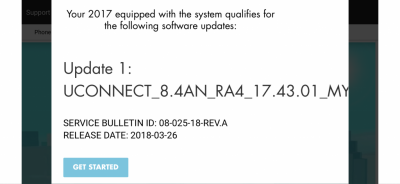

Hi Chief_6.7 and TomT,
Have you checked to see if there are any software updates available for your truck? You can find out by entering your VIN on the following link:
https://www.driveuconnect.com/support/software-update.html
If this does not help, you may also send us a private message where we can look into this further for you.

Ok next question how do I update???
Click that "Get Started" button and it will guide you through the procedure. Have at least an hour set aside to do the actual upgrade. It's not hard, just time consuming. You could also go to the dealer and pay them to do it, but I wouldn't if it was me.

I've had the same issue lately. Was wondering if there was an update that I needed to perform. Haven't checked yet.
There is an update of you click the link above and enter your vin it will let you know. I haven’t done it on mine but I will some time this week
