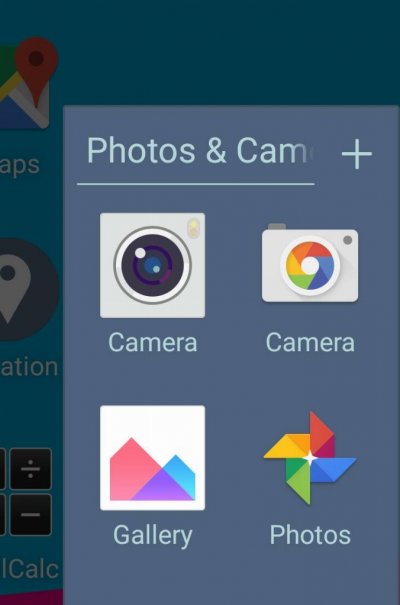

Thanks for the picture rotation!
I hate the way my pics post now days
Don't use the default "gallery" app and camera it doesn't always update the thumbnails correctly to show if a picture is rotated before posting.
I have come to rely on Google's official "Photos" App and Google Camera app.
It's the two on the right (can't uninstall the stock ones)
https://play.google.com/store/apps/details?id=com.google.android.apps.photos
https://play.google.com/store/apps/details?id=com.google.android.GoogleCamera

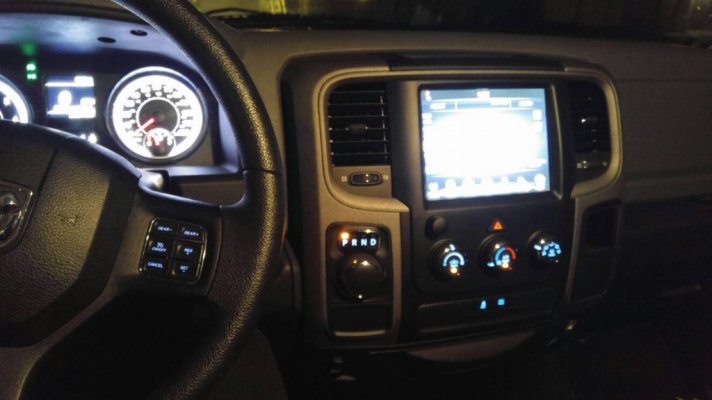

Super weird and I'm shelling out money like crazy because I hate this radio.. I shipped it out today so we'll see what he says
Sent from my LGLS991 using Tapatalk
That frickin sucks man. The Facebook guy that you bought it from may have likely known it was defective. If so, that's who you should be upset with.

Yeah. I've spoke to him before too. They do a great job over there. But the folks here on the site seem to keep getting things to work that the experts keep telling us isn't compatible.
Let them fix it and then plug it in without that bezel and it's volume knob/T-harness to check it. It's possible that the bezel & harness may be bad and affected the radio originally. May want to send the bezel to them to verify its not defective if you plan on using it again vs a full 8.4 conversion. May be okay too.

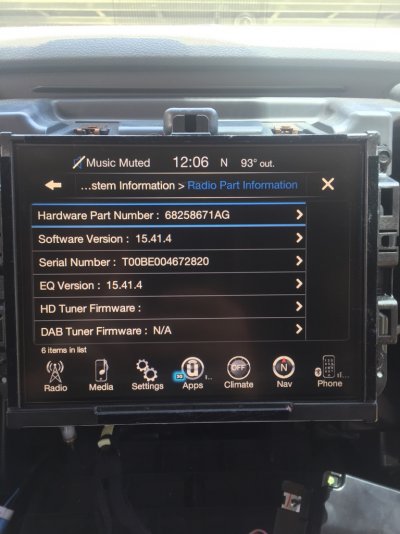

Did I ever get the pn and fw version of your 2016 RA4 from you for the RA4 FW Info thread?
If not please post here ...
Up All Night Sleep All Day via my LG G4 on Tapatalk
Talking about this? Ended up taking this during the install.

Yep. That's what I'm looking for. Thanks
