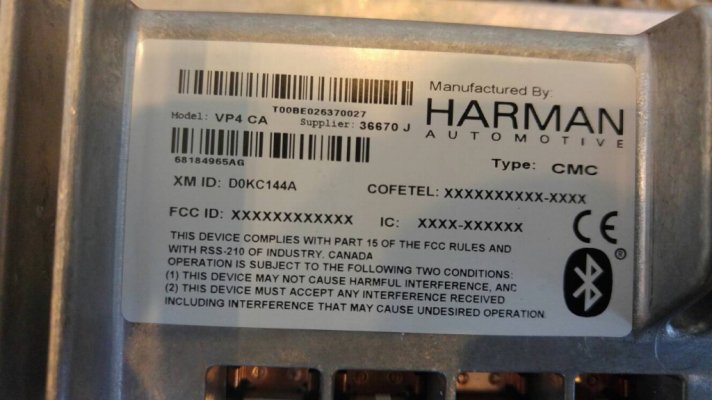

LOL! who said that ?
I have a 14 Ram with a 2013 RA4 8.4 CA Canadian radio In my truck , works great with full functionality HVAC & volume control on an OEM single zone bezel with the conversion harness and HVAC module .

Several have installed the RA4 8.4 CA 2013 radios in 13 + Ram's , are you sure they're not talking about the 4 speed hvac in 2013 as opposed to the 7 speed hvac in the 14 + trucks ?
Mpgrimm2
Mar 30, 2014
6,096
4,175
2022 Ram 1500 (5th Gen)
There ya go CTS.
RLK there has the exact same 2013 Canadian radio in his 2014 express as you would have if the radio worked...
He even has. the exact same letter suffix at the end of the radio pn as you do
(68184965AG) ...
