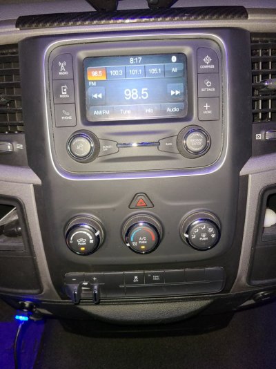

I have a 2014 Ram 1500 tradesman. I have access to a 2015 Ram 1500 with a 8.4 uconnect. What all would i need to take out of the 2015 Ram to make the 8.4 uconnect conversion into my 2014. Screen, bezel, fan blower, and blower module? Any advice will help me

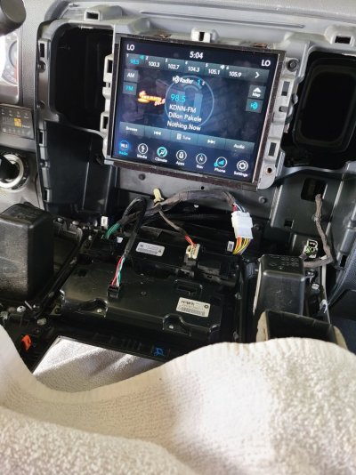

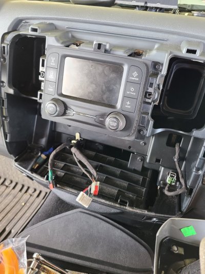

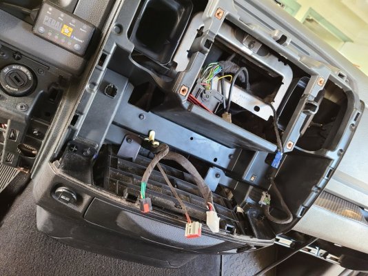

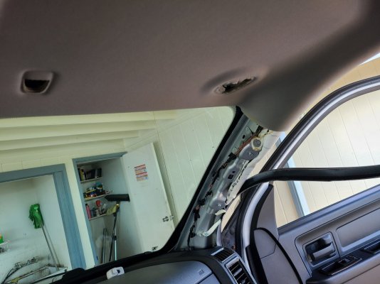

Going from a 5.0 Uconnect with manual a/c controls to an 8.4 Uconnect (which has touchscreen climate controls) will take alot more than just a headunit and plugNplay. @Mpgrimm2 on this Forum is the master at guiding folks with this conversion. In addition, you will require "flashing" your BCM with the proper a/c protocol, along with the AlfaOBD app and an OBDII dongle (like OBD Link). Additionally, you'll need to swap the radio bezel (with a/c controls), an adapter harness, a new a/c module, a cabin humidity sensor and headliner harness, and a cabin temp sensor. I did the 5.0 to 8.4 swap as well for my 2014 and for me it was well worth it! I put in a 2018 UAQ Nav/CarPlay/AA unit (which also needed a usb hub swap and adapter harness) and "flashed" everything myself, with no dealership needed. Hope this helps!
