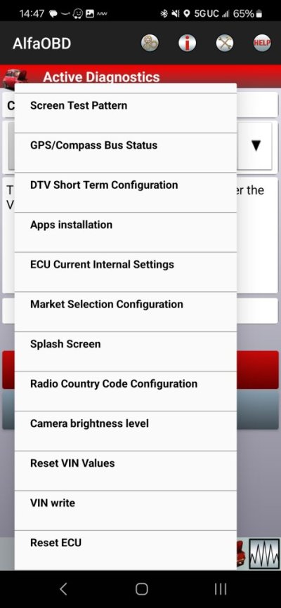

Ok, on my Android version of Alfa, I would run the bottom three in the listed order to reset VIN, write VIN, then reset the ECU. I would also clear any stored codes (maybe before resetting the ECU).

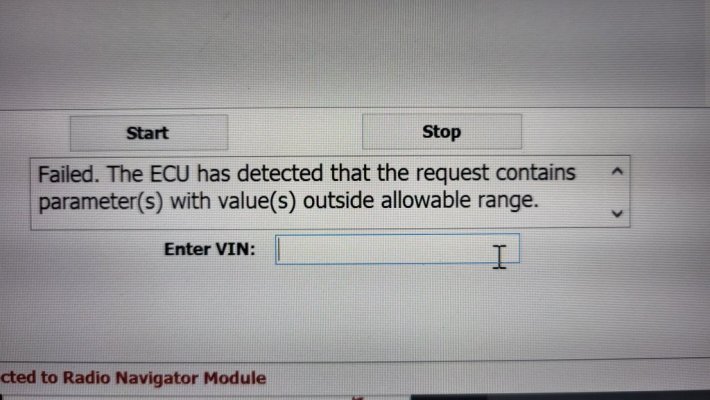

Its Not allowing the reset.
