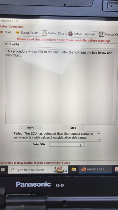

After a battery disconnect the bcm will still not accept a vin write, this is with original radio installed.
This is also the same message that comes up when I attempt to write the vin to the new radio.

Also for reference I'm using the usb type obdlink ex and alfaobd on a PC.
