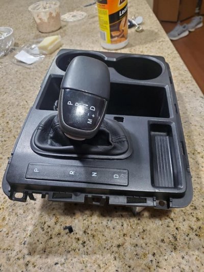

I'm running the SGA kit with the dial shifter as a stand alone with my Cummins. I would like to install a console shifter so I can up/down shift when towing and wonder if anyone has successfully done this? Russell at SGA says it has to be the charger/Challenger shifter.

Has to be that shifter or I'm pretty sure the TRX shifter will work as well. It looks it's better set to integrate into a Ram console (if you have one) than the car version would:

The bezel is really what I'm interested in as far as the swap. Is there a stock bezel that will work in the 4th gen ram and take either the car or TRX shifters?

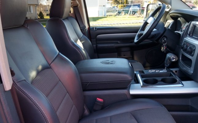

Not without modification. The TRX bezel is fitted to the 5G console, different but might be made to work. 4G consoles were only ever mechanical shift (RFE) or open with the dial shifter on the dash. I've been eyeing the TRX shifter (and surround) for this very reason when I go to do this in my 03 since it already has a 4G console, might be an easier option vs cutting up the stock plate:

I bought a shifter and bezel ($75) from a 2010 1500 today as a starting point. Now I need to find the Challenger shifter to see if I can marry the two together.

Oh very nice! so the Challenger boot does cover the old gate holes which is what I was concerned about. Link to that page?

Found it, thanks for posting that, nice to know someone has made it happen.
