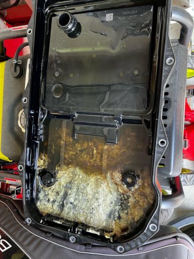

I am glad the TCM is not working as it forced me to open the pan and discover this deliciousness. This definitely wasn't flooded. /s
I believe some of the factory pans had drain plugs, as this one did, with FILTRAN filters. Can anyone confirm?

That's nasty looking. Maybe time to bite the bullet and have it rebuilt? Can you get some money back from the seller?

Probably go for rebuilt, I was going to see if I can find corrosion or somewhere on this TCMA and get it working because the aftermarket remanufactured valve bodies that come pre-flashed, are sold out and then I would have to pay extra for a MOPAR remanufactured TCMA + core and then it still wouldn't be flashed and have to figure something out for that.
If I can get this one working by some miracle, then I will probably just get the entire transmission flushed and get it up and running, then it will cost me nothing to drive it for a bit and get it rebuilt down the line. I really just need a working truck for a bit and to stop putting DD miles on my mustang.
I am going to text the guy I bought it from but I bought it last September and if he's a weasel selling bad parts, there is no way I am going to convince him that nothing happened in the past 9 months, even though, nothing happened in the past 9 months. Maybe he's honest and didn't know, but I doubt it.

Send him a link to this forum if he questions you. You have spelled it all out on here. What did the oil look like that came out? If you have "tuned" the TCM with HP Tuners then changing to a new TCM would cost you the credit for another TCM so I hope you can get that one to work. :(

Most of the fluid that came out of the drain plug was good, every now and then was a goopy drop but the lip on the inside of the pan acted as a weir and kept all of the emulsion mostly within the pan. I never had this transmission tuned as I have never been able to get a response from the TCM to get it working in the first place.
