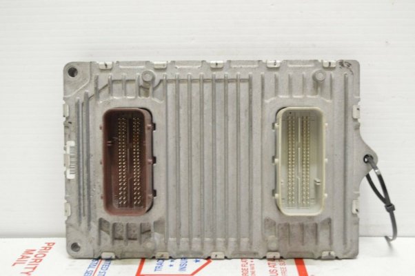

That's what i'm gathering as well. The brown connector came with 8 speed optioned trucks.
t0ymach1n3
Dec 16, 2021
219
183
Oklahoma
5.7L???
This is what I have. Is this "brown"?
Sorry, I might be color blind
That's the 6 speed ECM. The brown one(8 speed) looks like this. Wasn't too difficult to find one (Got mine last night on eBay for around $100 shipped). The wiring harness for the engine/trans.... that's a different story lol
