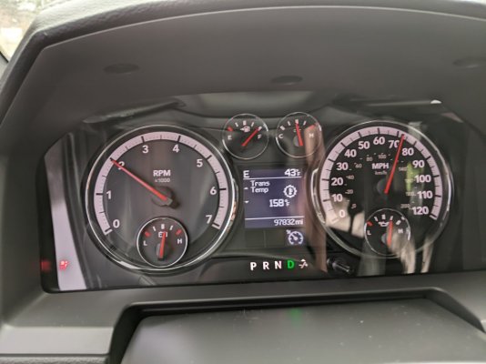

Check out my pics.
I used the 145 version.

I'm tempted to swap out the factory transmission thermostat on my wifes 8 speed Challenger to the 145 version,as it does get a little warmer then i like on back to back 1/4 mile passes,and doesn't cool down very fast on the return road
