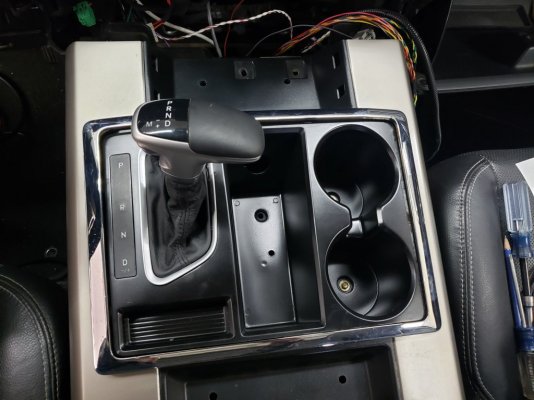

The amount of time Russell spent on my Cummins swap was impressive. I sent my TCM to him and love the manual mode and console shifter.
Dodge Boy Calibration 8HP <[email protected]> was the only tuner that was able/willing to spend the time and get the trans tuned the way I wanted it. The off throttle downshifts are fantastic.
