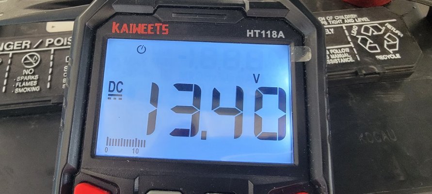

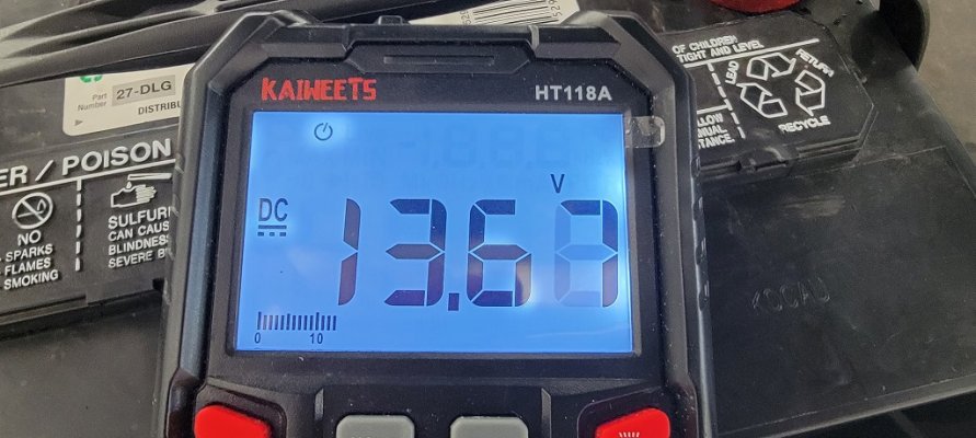

So I decided to do a Parasitic Test on the battery, as well as take some pictures of what the output from the Alternator is. I'm hoping that y'all can help me narrow it down to if it is still a bad Alternator, or a bad battery.

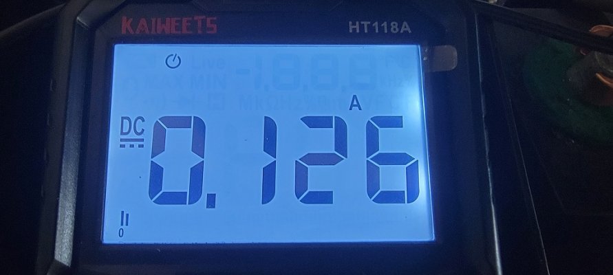

Parasitic Test Results. I even pulled the IOD fuse, and there was no change on the amperage. I tested all the fuses that I could, and they are all 0.00mw.

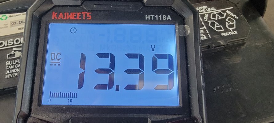

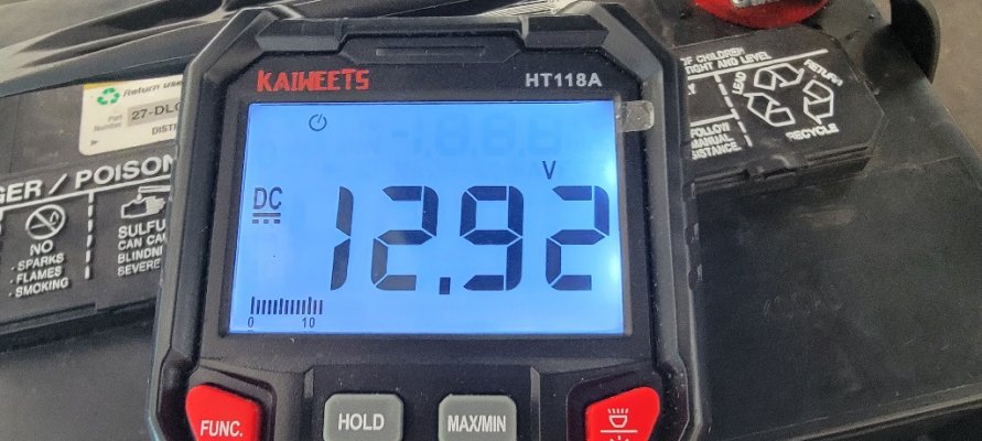

Then after starting the truck, I put it in Reverse, Headlights On, Max A/C, and this is the result at idle:
Then I left it in Reverse, Headlights Off, A/C Off, and this is the result at idle:
Then I put the truck in park, Headlights On, Max A/C, and this is the result at idle:
Then I left the truck in park, Headlights Off, A/C off, and this is the result at idle:
To me, these results seem a bit on the low side for the alternator output. Especially when under full load at idle.

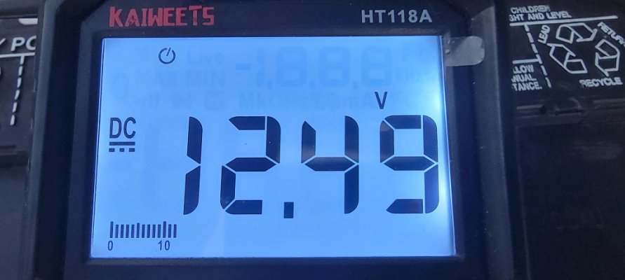

I did a couple things tonight, and I'll check again in the AM. I disconnected the battery from the truck, and this is the reading my DVOM gave:

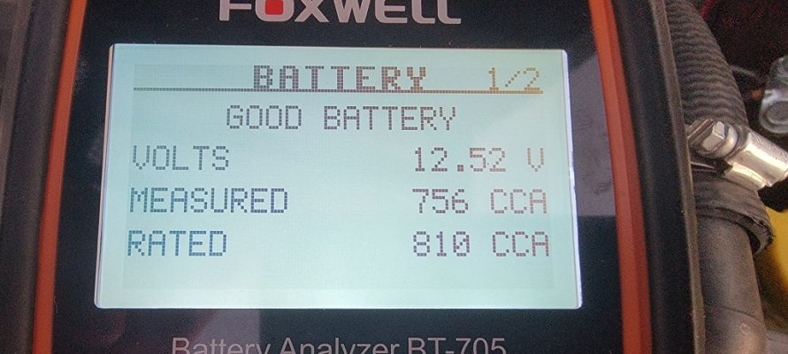

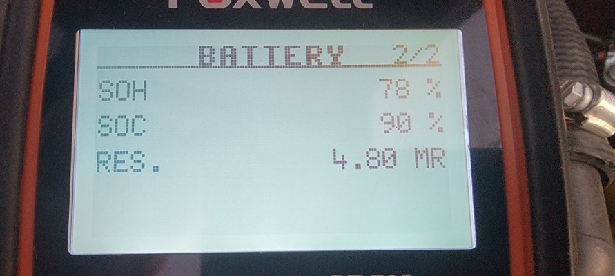

I then went to my Charging System tester. And this is what I got. Now remember, last week I said the truck was completely dead! It was showing "Replace Battery", but it also 4 or 5 days since I started the truck, and the battery was so dead, the dome lights didn't even come on. I only put about 30 miles of freeway driving on my truck, and it was clearing stating to replace the battery. Current results this evening (after Sunday evening - yesterday on the charger/maintainer):
When I ran it over the weekend, after driving the 30'ish miles back home at freeway speed (around 2.5K RPM), it showed measured CCA was under 400, SOH was about 45%, and SOC was about 68%, and the resistance was almost 9.2.
