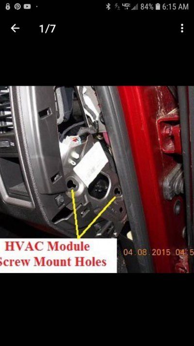

There's been a few here that have experienced a failed HVAC Module ..it's located behind the passengers side air vent , to access it's plug it's best to remove the glovebox ( lower one if you have two ) you may be able to get to the plug with the glovebox installed ? I removed mine it's simple and no tools required just hands . I also pooped out the passengers side air vent , again no tools just hands .
To remove the HVAC Module open the passengers door , remove the long vertical , football shaped dash side panel to access the screws 2ea located in the keyhole slots pointed out below in the picture [emoji1360]
