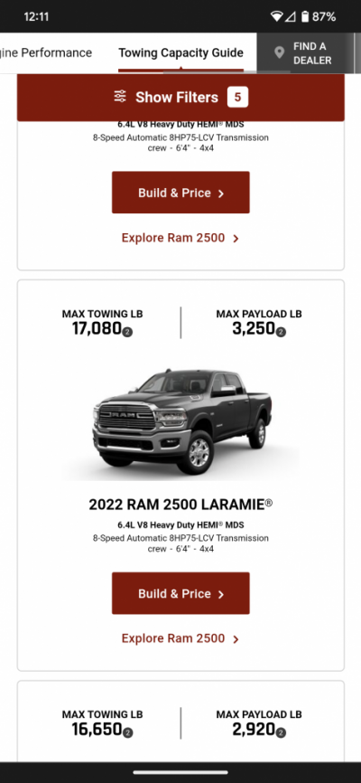

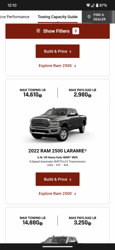

Ok yes, so when properly equipped, I see that, but going back a few of my posts, I was looking at 3500's and wondering why the same model, engine, trans and gearing could tow less, but have a 1000lb+ increase in payload. I spoke to a commercial rep at a local dealer, he explained the trucks are identical, the only difference is the suspension, leafs vs coils. Yes I know the mounting points are all different, that's been discussed already. I asked the rep, if I added additional support for the suspension, air bags, helper springs, to make up for the lack compression rate in the coils, could the truck safely have the same payload as the 3500, he said yes. It's the GVWR is numbered higher for the 3500s. The dealership also stated that the higher gears will increase payload because it is able to get the torque to the wheels better than 373's.
To me it seems like a numbers game, to fit the different classes of trucks. I don't know if anybody checked out that link that I added, but people have wrote that in some states you can register your truck higher than the GVWR. if anybody's familiar, it reminds me of the 1986 and 1987 Grand nationals. Buick rated them at 235 and 245 horsepower, when in actuality they were around 300. Buick did this because GM did want anything more powerful than the Corvette at the time, its flagship.
Edit* so is it like that, just what's put on paper to mostly satisfy for registration purposes. I order a 3500 that pulls less then a 2500 *if properly equipped*, but what's the point in that? If I get a 3500, I want an increase in towing like going from a gas to diesel, and a payload increase of a proportionate amount. A lot of people just accept that it's called a 3500 or 350 or 1 ton, so it's bigger, and must be able to do more work
