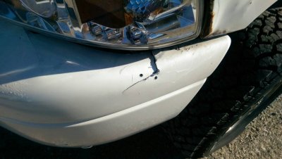

Now, with tires out of the way..(General Grabber AT2's), does anyone know what I can use to fix the bumper? I can't say I care to buy a new one if I can fix this one. uploadfromtaptalk1411566773923.jpguploadfromtaptalk1411566782212.jpg

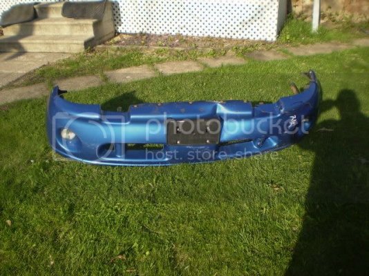

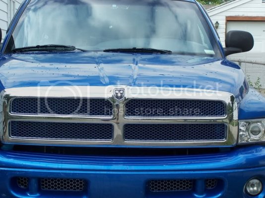

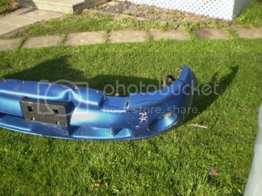

I used a soldering iron and melted the plastic back together. Used pieces from another bumper cover to fill in.
Before
And after

That looks nice!

I should have time to do this this weekend(hopefully), and no pieces are missing from mine, Just looks like frankenbeast the way I have zip ties holding it together. Did you solder the back side or do the front and sand it down?

Only the backside
