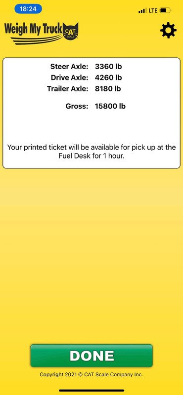

The problem is you will likely exceed GRAWR and GCWR before getting to your max tow capacity. IIRC GRAWR on that gen 1500 is about 3900lbs. I know for sure that a 9300 travel trailer on a 2020 Tacoma had 4260lbs on the rear axle and the trailer was empty off the lot with nothing it it and we were at 12% tongue weight. Granted it is a different brand vehicle and there may be other factors at play here but that TT is still 1000lbs below your max 'tow capacity'. Total weight was at 15,800lbs. His Tundra was rated to tow 9800lbs and you can see he wasn't able to get near that. Besides, I'm pretty sure it wouldn't be fun towing 11,000lbs with a 1500
