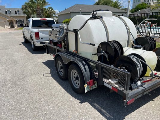

Looks like the fluid container is not centered on the trailer axles. It is putting more weight towards the tongue of the trailer.

Start by going to a CAT scale with the truck and trailer so you will know how much weight is on the rear axle and whether it exceeds the specs for the hitch. If not a problem then I would add SuperSprings to gain more support at the rear.
In terms of the trailer I would consider removing as much weight forward of the water tanks as possible.

As far as the OP's trailer, I agree it is not an ideal weight distribution. That's a lot of weight on the front of the trailer.
5 lug wheels means those are 3000 lb axles, so he is at max weight for the trailer - maybe over, maybe under - being a steel trailer his actual carrying capacity is most likely under 5000 lbs. if not 4500 lb.

Yes exactly, 3500 axles and local use only... I clean Chick Fil A's. I usually don't carry that much water. This is my back up vehicle, and the only truck I could afford without taking on a loan since the trans in my E250 is out. 1211 Springs should be in any day now. I'm also doing all new brakes and rotors. along with a radiator and new ac condenser fan. I still need to find a factory Brake Trailer controller. Thanks for everyone's comments I'm learning a lot and find this Ram to be easier to work on, and more enjoyable to drive than the fords

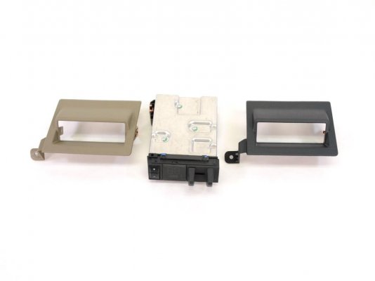

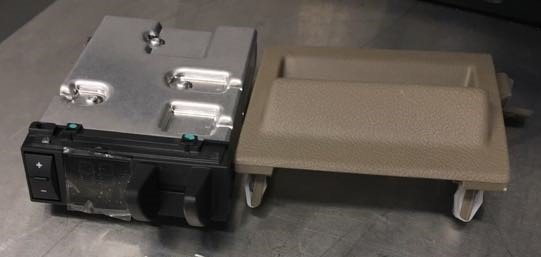

for cheaper OEM parts try, it's where I got my oem brake controller. I don't know if you will need to have the PCM flashed to activate the oem brake controller though (not sure on a 2011), I had to on my 16. I used alphaobd and a MX+ to do it.

The Springs should be here Tuesday or Wednesday, Destin is nice, Like everything great, it's getting crowded. I found and ordered a used OEM brake controller. Now I need to source a bezel. I can't post in the wanted forums yet, I guess I will have to wait. The trailer brakes will work with just adding the new controller. No need to flash. If you do flash, then the EVIC will display the trailer brake controller in the system. The controller will work without the flash. I'll look into those..
Basically, this is what I need to get the Trailer Brakes going. Just The trim bezel, funny thing is when you order the kit from Mopar it comes with two Bezels! depending on which dash color you have. so, I know there's a bunch of extra ones out there.

less water this time 2011 5.7 3.92.. and My 2011 e250 4.6 with about the same amount.
