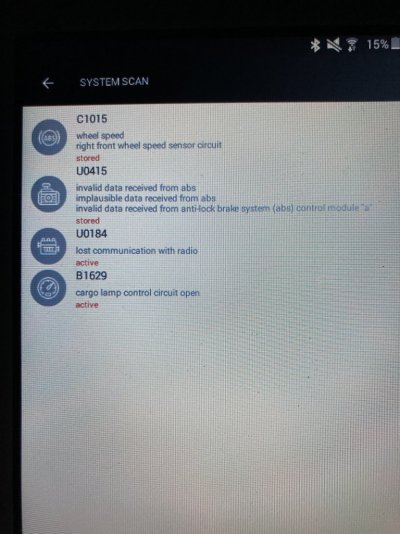

I've pulled the codes and points towards front passenger side (new wheel bearing installed in the summer). I did have an issue previously with one of the rear sensors but that would pop up randomly and not clear for a while sometimes. When the codes were present I monitored all wheel speeds while driving and the one in question would max out (or default) when truck was stopped and remain at that value the whole time. Once power cycled it would read correctly, same as the other three sensors. I just replaced my battery as the old one was shot and I was hoping that would be the cure, but unfortunately not.

Yeah, was really hoping it was the battery, since the old battery caused some other strange issues from time to time. Battery load tested good, I have one of those Princess Auto testers (our equivalent to Harbour Freight), tested it again this morning with a little fancier load tester at work. Connections good and I did remove and clean up the two ground connections close to the battery when I replaced it. Will check the other grounds this weekend once I pull her back into the garage. Checked the pass side sensor cabling and TIPM fuses/relays.
I did see the brake switch mentioned a few times and I could see if the issue were random and intermittent. But it's only the first time I turn the key over. This morning same thing, turned key off and back on again and codes cleared. I would much rather if it were an issue that stuck around, as it would be a whole lot easier to diagnose.
I do have a scanner and when the code is present that front pass speed sensor doesn't register. But it always comes back with the power reset. Everytime. And if I keep cycling the key the codes remain cleared. That's the part that's getting me, I don't see why a reset would magically cause it to work properly again.

I'm not sure all 4 codes are related. Note that 2 are stored and 2 are active. When you say they "clear", do you mean the light on the dash goes out or are you manually clearing the codes. Also, exactly what lights are being activated? Check engine light and/or ABS and traction control light?
No I don't think they are related, I'm not really concerned about the last two, they just happened to be there.

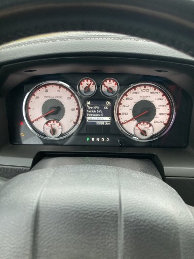

The first two say stored because I had just cycled the key off and back on again before I took that pic. Before I did that they were both "active." And when I say clear I mean the lights on the dash (ABS, traction control, and Service 4wd) go out and the faults revert back to "stored." I don't actually clear anything myself (I did clear all faults right after I changed the battery though to see if that would do the trick).
I'm going to test to see if 4wd actually works during these codes, but I'm assuming not if it isn't getting proper signal from one of the sensors at the time.
Edit: just left work after truck siting 8 hours. Results after cycling key
