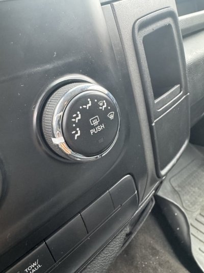

There are no codes at all, I have the oem radio and control panels. The air flow knob just blinks when not working
You may not be aware of any codes because of the scan tool used which is why Ken asked, what scan tool is being used.
Some of the less expensive scan tools won't be able to read certain codes.
So, what scan tool was used to determine there are no codes present?
