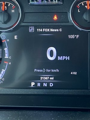

I’m in Houston and it’s been hot as hell this week. Snapped this pic as I got out of my truck the other day at 105 degrees at 4pm

Damn now that’s hot
I gotta move my son back to TTU in Lubbock next month, this was the temp Tuesday.
